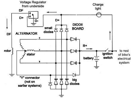

Here is the charging system!!
As you can see, the charge light will illuminate even without the diode board, IF all connections are ok to the rotor and the regulator is ok.
 With the diode board connected and the engine running, once the voltage reaches greater then 12.5v, the light will go out as the potential to the regulator connected side of the light, D+,  equals the 12.5 volts of the battery + terminal. Essentially, the voltage to each side of the lamp is >+12v so there is no potential difference between the lamp terminals.
The only time the lamp can't light with the ignition on and engine not running is if one of the larger B+ diodes to the right is shorted allowing +12v to flow through it and one of the now forward biased smaller diode on D+. The larger diodes normally will fail open circuit (though not always) if asked to carry too much current, as in a short.
I would still suspect something other than the diode board.
