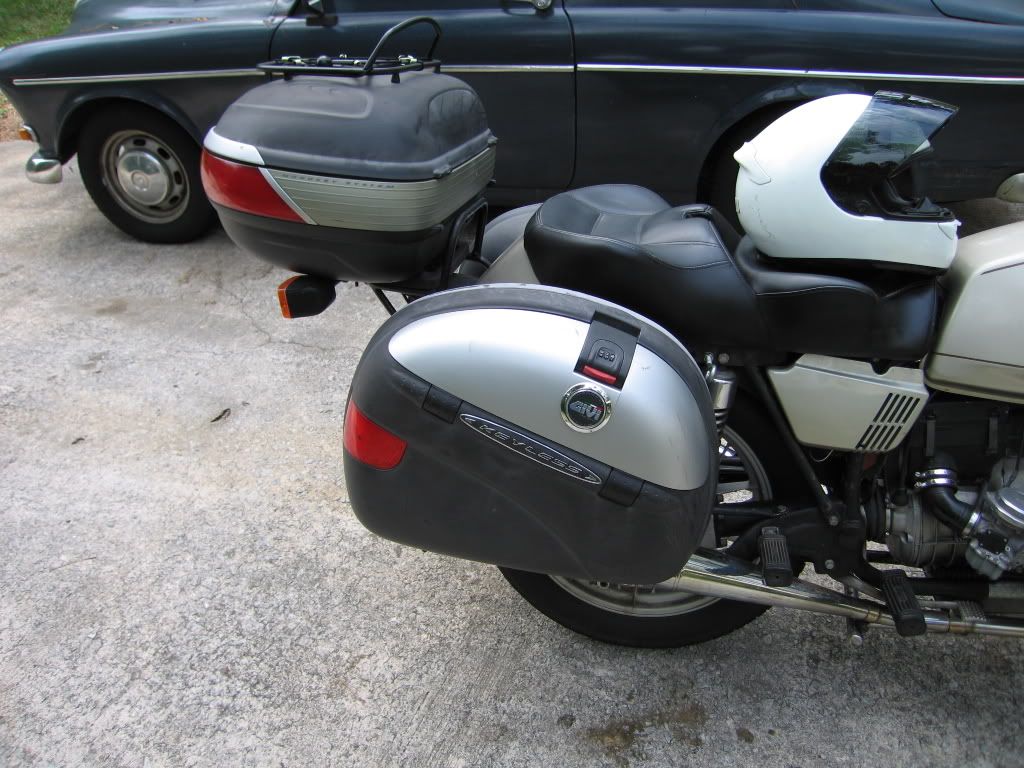

If you want to go expensive - Givi E46's mounted on universal plates onBMW/Krauser side racks with a Givi E52 mounted on a universal plate on the sames luggage rack.  You will have to re-enforce the luggage rack and most of the welds on the pannier rack.  You will also have to move the turn signals aft under the tail luggage rack.  Adds great utility though.
Easyier to see the turn signals in the second picture and the additional brace tubes....

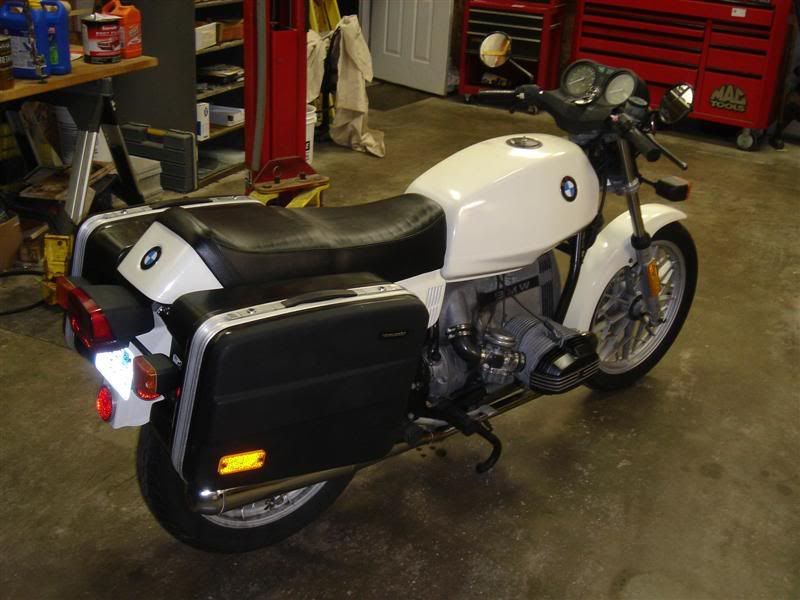

There are some nice looking bikes and nice saddle bags here.  I've seen Semper Gumby's when he rode out to California.   Justin's are nice, but they are a bit smaller than my BMW bags.   Spinachpie's are very nice, but those are larger than mine.
I guess I was lucky that the bags were on my bike when I bought it.  I think it wouldn't be too hard to find some.  But I'll bet it's hard to find used ones that are in good condition.
