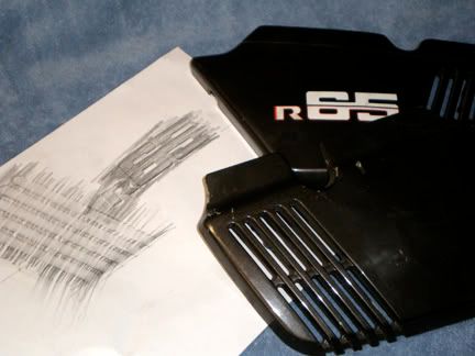

« Reply #4 on: January 20, 2011, 05:55:37 PM »
Took a 'tombstone' rubbing from my 1983 battery covers prior to refinihing them.

« Reply #5 on: January 20, 2011, 06:33:11 PM »
I think it all depends on the year.  Barbi's '84 had 'em in the middle...
