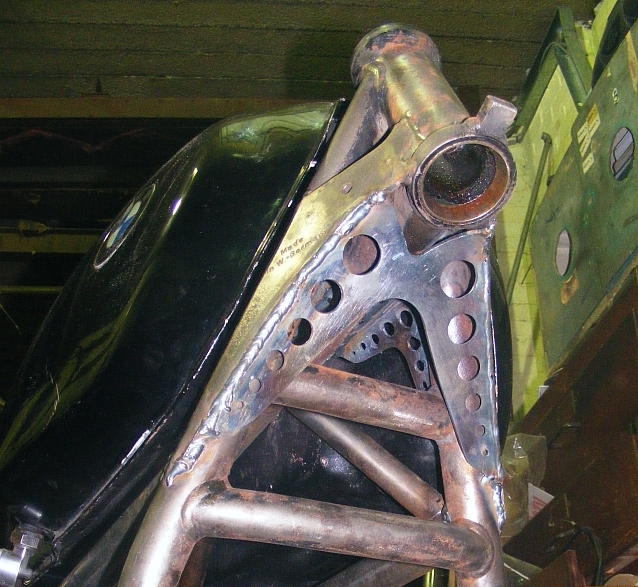

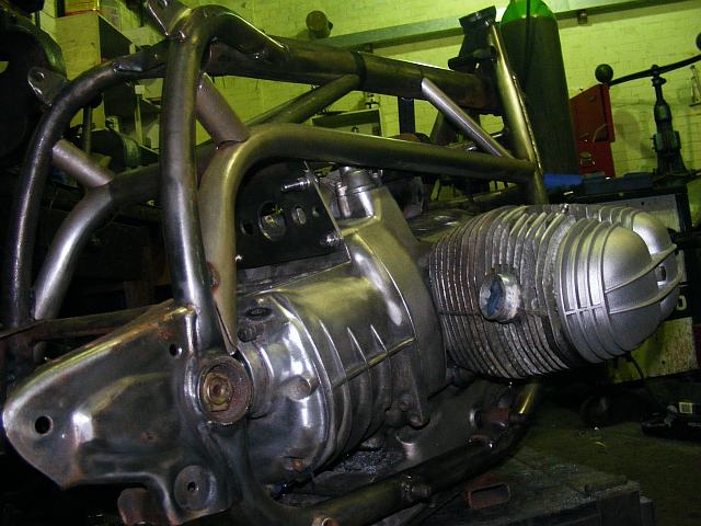

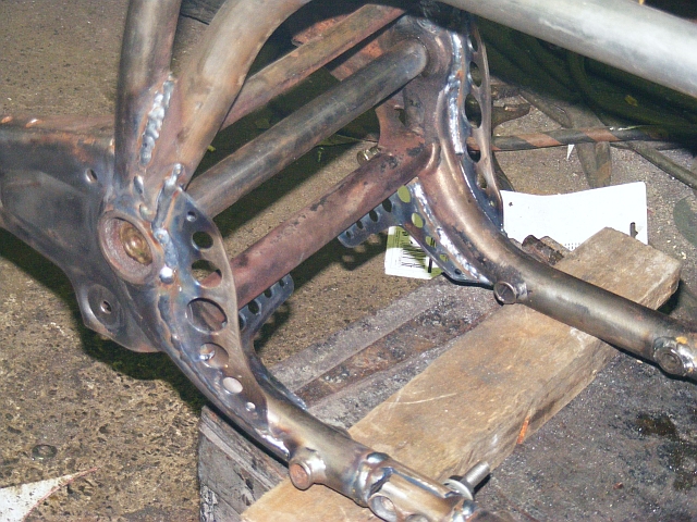

My R65 café racer project was the subject of a flurry of activity this week, and now has a stiffer frame,a lighter engine, a new top motor mount, and a removable frame rail.
More detail on the blog, if you're interested.

« Reply #6 on: December 13, 2010, 06:14:44 AM »
Do you think, that if I add enough gussets with Speed Holes for lightness, eventually the lightness of the holes will outweigh the added mass of the gussets?
Or not? :)

« Reply #7 on: January 02, 2011, 10:24:33 AM »
While it looks cool the headstock looks like overkill to my "un" trained eye.  I think you could achieve the same result from a smaller gusset crossing the corner on the headstock.  But I am not an authority on this.  You really need advise from a frame builder.  If you want rigidity that far down the tube from the head stock I think you need to cross the distance between the two tubes and make a triangle.  The triangle is what makes a rigid frame... not a couple of unsupported wings.
Sorry this is probably not what you wanted to hear...I will now apologise profusely and ask forgiveness.

« Reply #8 on: January 02, 2011, 07:52:13 PM »
Actually, according to most people I know, I am a frame builder.
Though mostly, I write about it these days....
