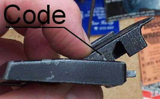

Any clues how to get into locked bags?  I'm going to a locksmith tomorrow.  Dealer wasn't much help but did say there might be a code visible when the locks are open.  The latch on the side isn't locked, but I can't see any numbers in there.  Bought new in 1982.

Not sure which ones you heve. These saddle bags (I tried to attach a photo) do have a number visible when the latch is open - they have the wrap-around type latch to the mounting frame rather than the seat belt type. Your locksmith should be able to open them easily - you could probably do it with a paperclip.

Is the key code visible on all locks or only the bag-closing locks?  I looked all around the other lock and didn't see any numbers or letters.

The proper mounts will fit the LS as well as the standard R65. They should attach at the inside of the shock mount, rear of the frame loop below the seat [little tab loop thingie, and at the passenger foot peg bracket [little hole in sheet metal] I can shoot some photos if ya need them. The bags shown in a post above are the BMW Touring bags. Some of these I understand were made by Krauser. Only the R65 specific bags fit, others rub the shock / frame. the optional luggage rack will not fit the LS model. Here is where the lock code is hidden
Duane has a good website with clear and consice info
http://www.w6rec.com/duane/bmw/bags/BMW/index.htm  That should be of use. Let me know how you make out with the locksmith / keys / mount

Fantastic!  That's what I needed.  I found the code so I can get a key at least, but if they are the wrong bags I need to get the right ones.  So the R65 bags are specific to this bike?

My Mono bags look the same.  The locks are "051" & "052".  Can additional keys be ordered?  I'm always worrying about only having one key to a lock...    :-/

OK, I went to Bob's and got a key no problem (1 in stock #050).  No buried treasure inside unfortunately.  The parts guru said the R65 doesn't have unique bags but does have different mounts (as described above).  He also said he'd never seen an LS with bags, but what does he know?
