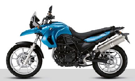

Lynn has selected the 2009 G650 Azur Blue Metallic that she spotted at Lone Star BMW in Austin, Texas. I may have to limber up my old sword striping brush. Where be me One Shot sign enamels?
Here's a photo of the color.
