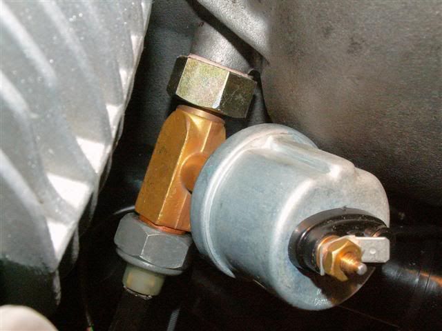

Giving this just a little thought, if you could find a manifold that would thread into the existing oil pressure switch hole, then install a pressure sending unit, and possibly the stock low oil pressure switch , so the 'idiot' light stills works, to get your attention if you happen to miss the indication on the gauge.

It would be fairly easy to plumb in a "tee" to suport the light switch and a connection for a mechanical oil pressure gauge...  Space would become more of an issue with the sender required for an electrical gauge.

« Reply #11 on: January 24, 2008, 06:31:43 AM »
I have this setup for the oil pressure sender on my 90/6, and the clearances for the sender is fine as it just clears the carb with mm to spare. However, as the 65's stroke is shorter, I recon the clearances would be much closer though I haven't tried it and it might need a remote tube up of the sender from the T connection, attaching it to a bracket somewhere on the frame.

« Reply #14 on: January 30, 2008, 06:08:03 PM »
Bill,
Thanks for the photo of the T fitting. Does anyone have a recommendation for a quality oil pressure gauge. The units at my local auto parts place all require plumbing. Are there any that use an electrical transducer? I think that might be the way to go. If not, perhaps a gauge mounted low on the engine somehow? I'm thinking I'd really like to add one if it can be done cleanly!
