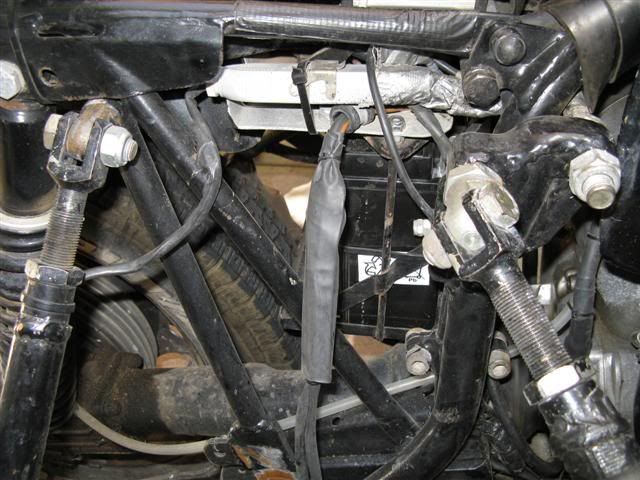

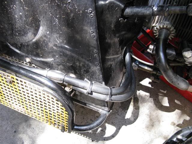

Why bother with choke actuator/cables at all??
Another way is to have a pull wire with loop to actuate the enricher on just one carb, the left usually. Only one carb so rigged is sufficient, and no return spring is needed if the wire is chosen carefully and installed with a little stiction. I haven't tried it myself, but others swear by it. Here's a pic of one installed an an R100 that the owner is currently riding around the world. He said it has never failed to start, and saves complexity on his machine, a purpose built sidecar made for all conditions. This enables him to also run a spare throttle cable running where the choke cable would, which can be seen in the background ready for instant changeover.

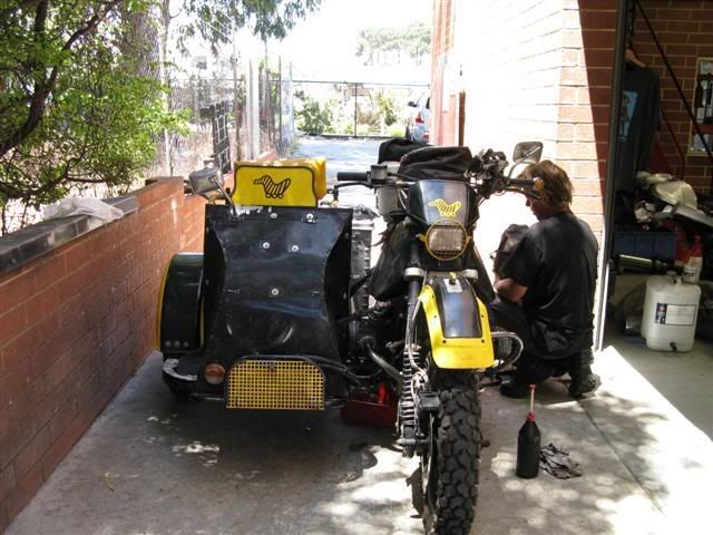

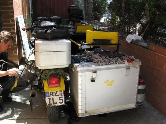

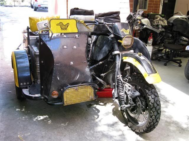

Your wish Mr Valdez!! I forgot how interested you were in rigs.
The guy used the back of the shop I work at to give it a service one day a about a month ago. He's in the pic as well. He and his Wife, both German, started in Germany, went to N Africa and other parts of Africa, rode to Thailand and from there shipped it to Fremantle. He'd just got it from the wharf a few days before these pics and was in a few days about to circumnavigate Oz before heading back to Asia.
He built the machine himself, along with the custom leading link front end. It was a pretty substantial effort and rugged rig, and it was great to have seen it and talk with him, as well as help in a few things. His manners were impeccable German, and when he left he thanked us profusely and gave a little head bow as well.........in fact I'm sure his heels clicked together at the same time!! LOL

Wow.  Looks like some setups I saw in some movies made in Australia...

That thing's a Tank! Did he say what the range/MPG was?

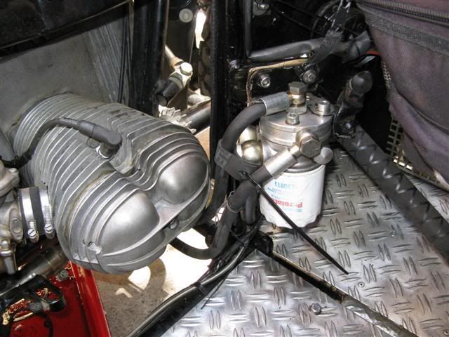

I ABSOLUTELY love the way the sidecar is open on the bike side!
It makes valve adjustments (not to mention oil filter changes!!!!) way easier!
I think my next car will have a removable panel to access those parts.

And an oil cooler heater for the wife's tootsies!  How cool is that!

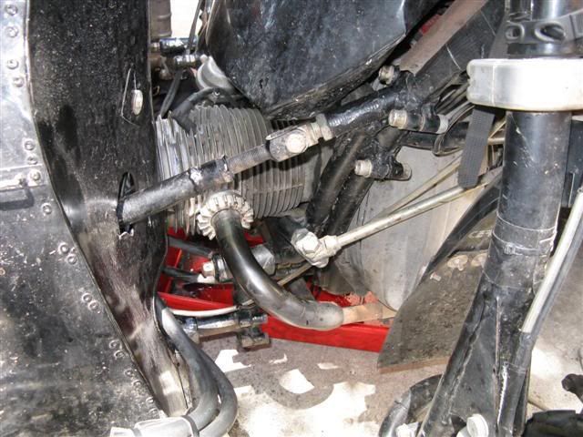

And what is up with the crossover on the exhaust headers?
Is the rear fender bobbed in front, where it goes down behind the battery?  That must make a real mess in there!
Not very, one would think, especially in desert regions!!
It had a crossover, but the right side diverted just behind the gearbox and merged into a two into one system and a muffler from another bike.
Can't remember offhand, but it was pretty busy there though very rugged so a little mud-n-dirt wouldn't have affected much. The whole rig was heavy but solid and he said uber reliable and had had no problems with it to date. Didn't ask about fuel economy!! Hard to get perspective of everything about it with the camera.

Very interesting.

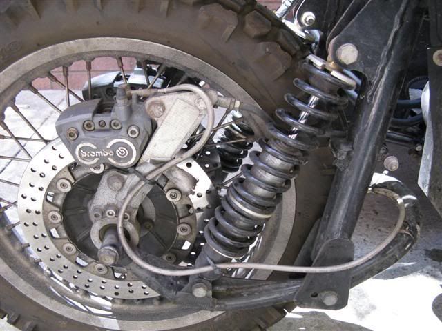

I suppose the driveshaft really works hard on a trip like this.........hopefully he keeps an eye on that swingarm  oil leak......

i love the oil cooler/ filter set up. i would love to have a rig like that for winter riding. this year has been a crazy year for snow. i have been looking at the ural & dpner hack set ups. one of those might be my next bike.

It does look like it is built for sturdiness, that is for sure !
Though, I think that I might have routed that front brake line differently so as to avoid the possibility of it getting hit by thrown up rocks, etc.

Love the knobbies!!!
