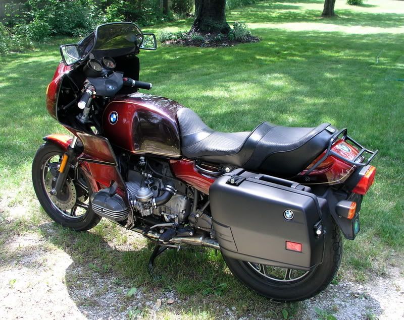

Check out this Red Smoke '88 RS I've just found: nice, huh?!!
PS: Don't forget the Rally pics, ok? [smiley=thumbsup.gif]

Steve,
That's a sweet looking ride!  Clean and I love the smoke paint.  Is it nearby?  I have NO experience on the R100s, so I can't help there... I have been a passenger on a R80RT.  It was comfortable enough, but I've always been partial to the RS style myself.

Aida, that RS is a sweetie, ain't she?! Found her on ibmwr.org, the last bike on this page, up in Wisconsin:
http://www.ibmwr.org/market/search.php?c1=a&c2=b&c3=s&field=title&target=R100RS&Mode=find
Here's the seller's direct link to lots more pics too. http://mountain.mulehill.com/~vince/R100RS

Ohh, that smoke red RS looks very nice (wipes off bit of drool from mouth)...
If only my customers would pay me on time, but then again, perhaps it is for the best
that I don't have the extra cash on hand right now ...
