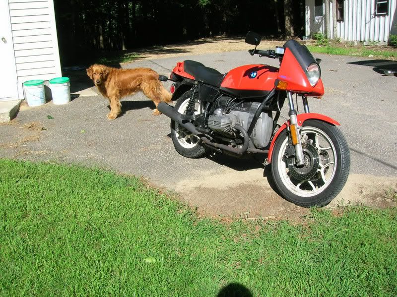

Bob and Justin got them all, I believe.
There were (2) versions of handlebars, both were painted black, as well.  The US versions had close to 3" rise and were fairly wide.  They looked rather out of place on a bike that was styled to look like you should be leaning down onto the little wedge shaped fairing to ride it.   The euro-version bars as much lower and shorter, and close to the bars from the R100RS, also painted black.
I think that the Polaris silver ones were all silver as far as bodywork goes, while the Henna Red models did indeed have a flat black painted lower fuel tank and black sidecovers, intended to make things appear longer/sleeker, I think.
The white epoxy paint used on the Red LS's wheels is annoyingly well known for flaking off in large unsightly chunks.  The paint on all the 2-part alloy wheels tends to crack along the seam where the rim part meets the spoke part of the wheel, but this is a simple cosmetic issue and is not a safety concern.
Here is my shop foreman inspecting my reassembly work this past summer:
