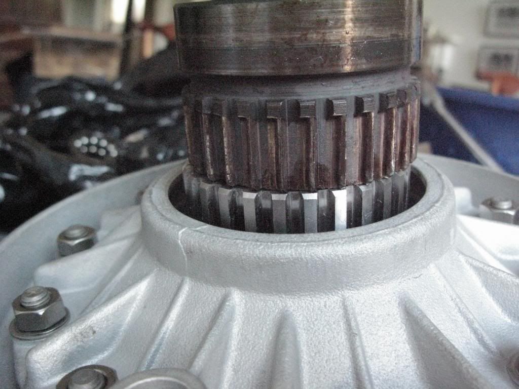

Which splines - clutch or rear wheel ?
Clutch splines are don't fail so much as dry out and cause gear change problems. A spline lube every 5 years or so will keep them in order.
Wear on the rear wheel splines will be obvious from visual inspection. A clean and re-grease at every tyre change is a good idea.
Comparison of worn and new rear wheel splines.

Re: Splines going bad?
« Reply #2 on: August 15, 2018, 04:23:25 PM »
How do you tell if they are going bad? Is it obvious on visual inspection? Who has experienced their demise and replaced them?
thanks
Which ones?
Gearbox input splines (new gearbox input shaft required - rob bank).
Final drive input coupler set (new set required, take lots of money)
Rear wheel drive splines - (new drive cup required for wheel and new output shaft for final drive required - the parts are relatively cheap but the costs of the skills needed to do the job properly varies).
So which splines have you buggered up?
