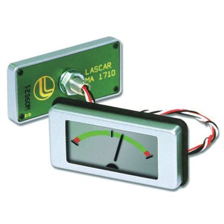

... with a  little ported 12v vacuum sensor mounted conveniently under the tank.   there are many many versions of "zero center scale" meters and gauges out there.
Barry, I wonder if you might be able to identify a couple of components I might order for tinkering with.
What version of the following SMD vacuum sensors might be appropriate for a pretty straightforward application to the
little meter shown above?
https://www.arrow.com/en/products/mpx2010dp/nxp-semiconductors?utm_source=google&utm_campaign=g-shp-us-sensors&utm_medium=cpc&utm_term=PRODUCT+GROUP&gclid=EAIaIQobChMIuL2G3dDR3AIVBgppCh1sLQ_bEAYYASABEgJzkPD_BwE&gclsrc=aw.ds&dclid=CM_JiO3Q0dwCFQJZwQodCtAEtA
There is a PDF datasheet link on the page that describes the various packages of these sensors
This is a data sheet on the LED meter...
https://www.lascarelectronics.com/lascar-panel-instrument-ema-1710/
« Last Edit: August 03, 2018, 03:11:23 PM by svejkovat »

All of the pressure sensors seem to have the same range and output  of 0 -10 kPa  and 1 - 26mV  That's not too bad range at approx 40" water gauge if a little high by my previous criteria. The problem is that the output is only 1-26 mV  while the meter is 1 volt FSD so it's not going to work. Well it would sort of work but a change of 1" WG would only deflect the meter by 0.07% of it's full range. If the meter was matched to sensor then it could work much better.

If it could be done in any sort of plug-n-play fashion, I'd love to dash mount a little round zero center scaled mechanical/analog meter connected to the carbs by tubes.  If not, perhaps an mA or volt meter with a couple of sensors.
But, conceded, it's looking less and less plugnplay, and perhaps not worth the effort presented after all.
