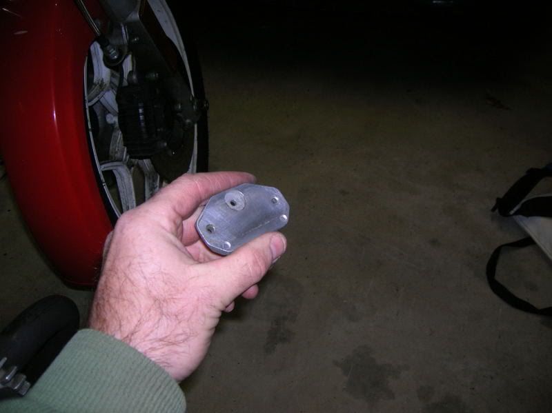

I took some photos, in case it would be helpful to the less mechanically inclined.  While under there, I also took the opportunity to cleanoff the heatsink on the ignition control unit and reinstall it with new, quality heatsink paste between the ICU and its aluminum heatsink.

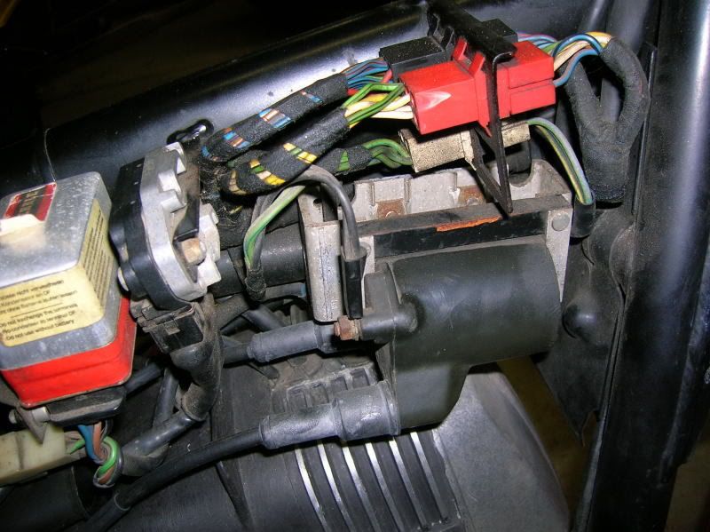

First, here is a photo of the area of interest, with the fuel tank removed.  you can see the OEM coil on its aluminum alloy bracket toward the middle of the photo, and the ICU with its aluminum heatsink to the left (just in front of the large rectangular silver "box"...

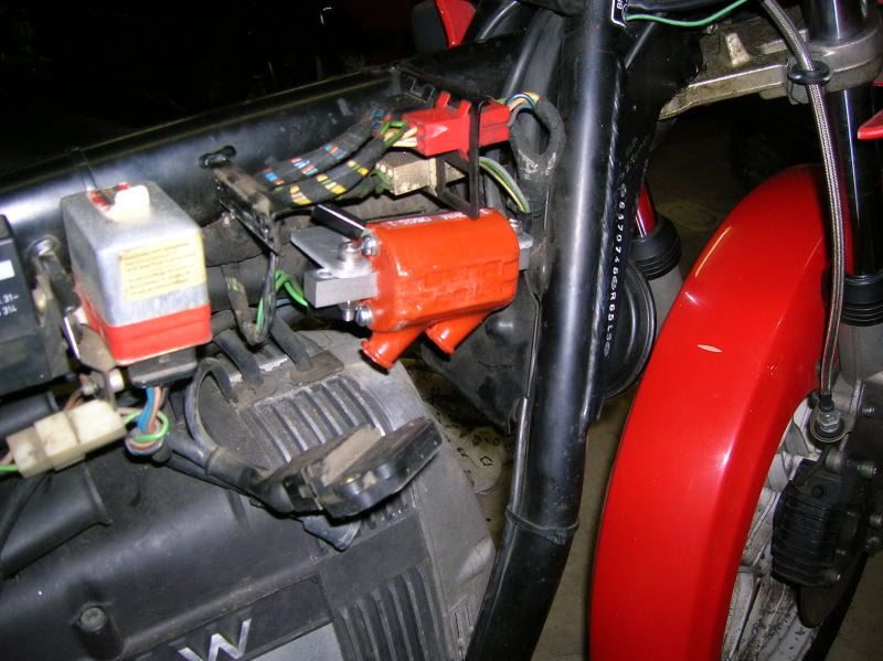

I removed the OEM coil and installed the Dyna "brown" coil using the brackets and hardware provided.  They also provide you with instructions, which are correct.  Here is a pic with the new coil installed (plugwires not yet connected) and with the ICU unbolted from its holder.  I used a brass brush (lightly) and some emery cloth to clean the residue from the heatsink and metal backing of the ICU.
Make sure that both mating surfaces of the ICU and heatsink are clean and smooth.  Use a silicon heatsink paste (obtainable from many places, include the everyday Radio Shack stores here in the US)

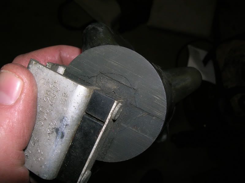

Closer inspection of the original coil showed that IT HAD INDEED BEGUN TO CRACK.  Again, I  hadn't had ANY problems with it to date, but had also been avoiding riding in heavy rains, and I am SURE that it was only a matter of time before I got left on the road someplace.  you can see the cracking that had formed on the front end of the coil
here:

Thank you nhmaf! I think a lot of folks will benefit from knowing where that heat sink paste needs to be applied!  Also, your pic clearly shows that the bad coil part number ends in 200 while the good coil part number ends in 203. Of course, dyna coil is a fine replacement too!
