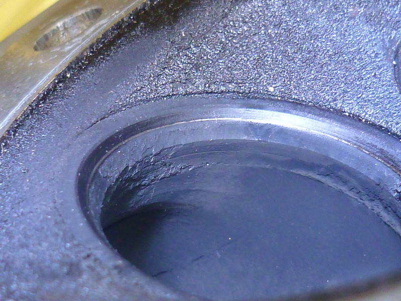

To quote Snowbum
"The new valve seat material introduced in 1980 by BMW was a SS, high nickel-chrome alloy. NOTE that this seat material can be identified by a SINGLE scribed line on the inside.  The later 1985+ PROPER material valve seats have TWO scribed lines."
Snowbum doesn't describe how to find the lines and they are not what you might think. They are concentric lines forming a circle on the inner surface of the seat.
« Last Edit: June 15, 2016, 11:51:46 AM by bhodgson »

« Reply #12 on: June 17, 2016, 09:40:53 AM »
Ah barry, that looks good! Shame there isn't a way to know without getting the head off.. or maybe if you are clever with an inspection camera..
