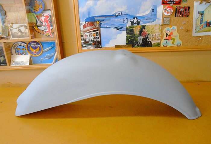

« Reply #7 on: January 14, 2016, 03:18:04 PM »
Resurrecting this thread in regards to modifying and painting an Airhead rear fender:
The Airhead fenders are fiberglass. Prior to laying up the glass fabric in the mold, a gel coat is first sprayed into the mold. This is the creamy white color Barry mentioned. Gel coat povides a near flawless top coat. After removal, trim and full cure, the fenders are painted a matte black.
The rear fender on my R100S has been trimmed and the tail light is tucked up under the seat's tail piece. Not quite like the current crop of tall arsed sport bikes. You may notice the fender's edge is absent near the tail end of the fender.
Much of the OEM black painted components on the R100S are now powder coated gloss black; save for the scruffy, scratched matte black rear fender. We're going to fix that.

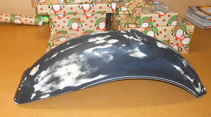

First photo shows much of the OEM black paint sanded off. Several thin spots in the gel coat exposed the fiberglas cloth weave. These spots are going to be filled along with some pits and scratches. Light smears of body filler and quite a bit of sanding preps for primer.
   Yes, those are some of the grandkids Christmas packages. It was 2016 by a week before the fender was installed

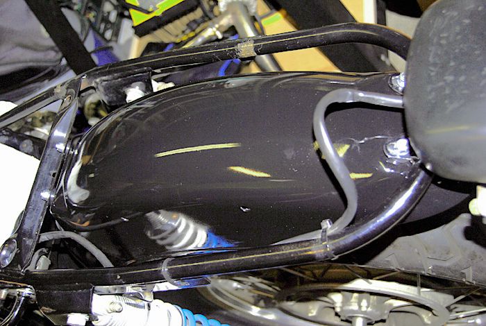

Next photo is of the second coat of high-build sandable primer. First coat was worked down almost to the gel coat and filler. Last coat required only a light touch of 400 grit, used dry. Note: The primer can absorb water which will slow down the job until it all evaporates.
After shooting a couple coats of gloss black and letting the paint cure, I was almost out of time prior to taking off on another road trip, hence no pic of the unmounted shiny black fender. Could not bear to use the weathered hardware so new metrics finished off the install.
Most of the hours rehabbing the fender were spent in sanding. The actual color shoot took about 3-5 minutes for each coat. I spent nearly an hour cleaning the spray gun.

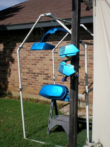

The rear fender on my R100S is barely visible but I see it every time I open the seat. You are exactly right regarding preparation. At least 90% of your time will be spent doing the nasty part. Actual color spray goes relatively fast.
   For the fender, I bought a half-pint can of Rustoleum Gloss Black enamel. Reduced the paint approx 15% with refined mineral spirits and added a speck of flex agent. Leveled out nicely and the gloss matches the powder-coated tank and chassis.
Painting an entire motorcycle requires the same attention to prep work. When purchased, my 1983 R65 ran beautifully but was butt ugly with terrible, orange peel paint. Did my prep, set up a ghetto, tarp wrapped, paint booth on the patio and shot a BMW metallic blue. The sunshine does a number on the metallics in the paint. It's actually all one color.
Buy your supplies from a legit body shop supply vendor. The '83 got Dupont acrylic enamel with a gloss hardener additive. Reduce the paint with an appropriate ambient temp reducer. Clear coat if you wish but I did not. With a new DIY seat cover. Wrapped headers to hide the fugly pipes and with repop Norton Peashooter muffs, well, I think it turned out rather nice. The silver pinstripes on tank and tail piece are vinyl -from the paint shop store.
Your personal labor is free. Materials for my job ran about $125.00 Go for it.

There's an English Color shop in Denton. At least there was last time I looked. All my materials were purchased at Color Service. Another helpful shop.
I bought the primer recommended by the vendor. You'll do a bit of sanding there. Muy dusty. Also shot a coat of sealer over the primer before color. The items on the "tree" used a quart of a metallic color. I was advised that by adding the gloss hardener to the paint would not permit wet sanding the initial color coats. Delete that paint additive and you could, if needed, wet sand away any minor sags or runs, then shoot a coat of clear. Wherever you shop for your paint supplies, tell 'em your a hobbyist, not a commercial shop. I've always gotten discounted prices from Color Service.
The '83 R65 paint job was completed about six years ago. Like groceries, paint prices may have gone up a wee bit since then. You'll still save some serious cash doing the work yourself.
And clean that paint gun when you're finished. My primary gun is over 25 years old and still works as new. You'll save money there, too.
