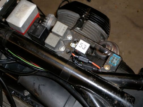

Definitely need to add a relay and a fuse
The factory relay sockets are cheap    and there is space for 3 extra ones right were Monte has his inline fuses :D

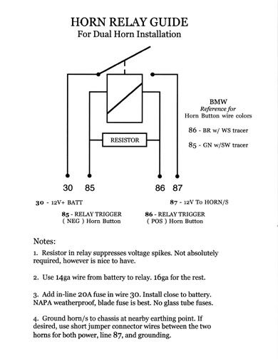

Plenty of room for the horn relay (#53) and the NAPA fuse holders. I have collected several used Airhead wiring harness over the years. I can usually find the correct relay socket in my stash.

Most horn relays, most, have a resistor inside the relay case to reduce arcing and wear on the relay's contacts. Once installed, the horn button wires (#85 & #86) are used to operate the relay contacts; not a heavy electrical load. #30 & #87 carry the higher amp juice to those Freeway Blasters.
