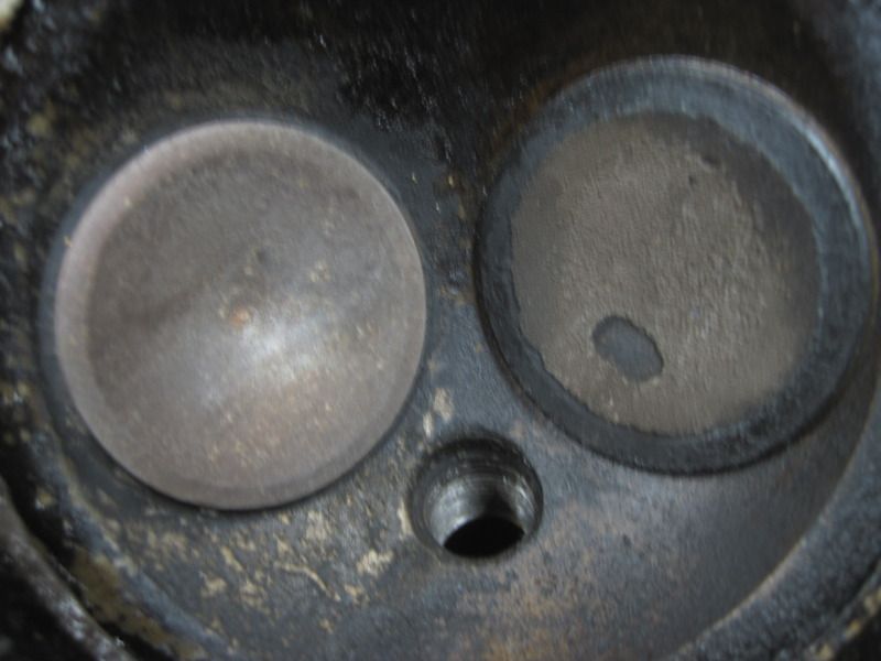

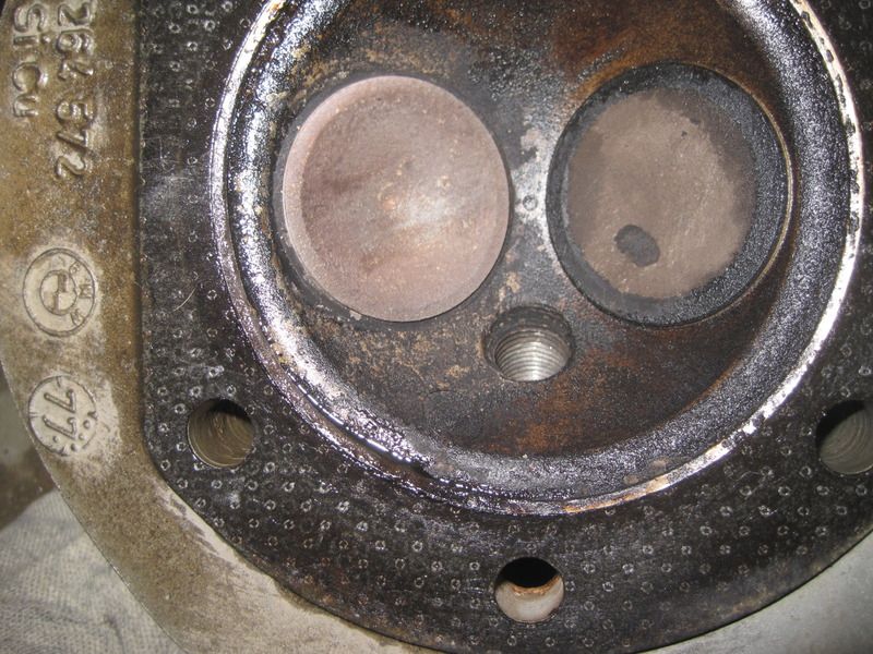

Pulling my cylinders because of leaking push rod tube seals - now that I've pulled the worst offender I discover that my 1978/79 R100/7 has the non-brazed push rod tubes... so maybe I could have fixed things with some small hose clamps and enough pounding.
Anyhow, I noted that the valve lash seemed to have closed up to .004" on the exhaust and .002" on the intake in the past 800 miles - I thought that I had set it to .004" and .006" previously, but maybe I had made a mistake.   I was planning to keep the head and the cylinder together, but decided to take them apart to look at the valve heads.   The pics are prior to cleaning, but the tiny dimple in the middle of the exhaust valve (on the left) seems a bit odd to me...
Could it be starting to deform?  Maybe the closure is due to all the carbon - I'm still trying to get it running better - way too rich these days.

How many miles?
Even R100s will drop a valve eventually, if you do not know the miles and do not know the bike's history I'd be having new exhaust valves fitted anyway, and frankly, for the money involved, I'd do the inlets as well.
I'd be more concerned with the apparent gas leak past the sealing edge of the head gasket in the short term.

You need to see the sealing surfaces of the valves to tell whether you have recession or not .

I'm going to look at this more closely - at initial glance, the edge of the valves seem normal thickness - not getting thin/sharp, but the odd looking dimple in the middle had me start thinking about possible head/stem separation.   I have no idea if the seats are originals from 78, or if they'd been replaced with the non-conducting early 80s seats, or what...
Save your money on new seats, in the case of 999 out of every 1000 airheads they aren't needed. and guess what, 1 our of every 1000 airheads with the later supposedly better "lead free" seats will suffer valve recession anyway.
New valve seats is money you spend only if your old ones are worn, or if you actually do suffer recession.
You should however get the valves done and unless the head to barrel mating surface cleans up perfectly, look at getting that face machined (you can buy spacing rings from BMW to restore the correct combustion chamber volume).

I thought Valve plastic deformation was caused by the new valve seats introduced to combat valve seat recession being poor heat conductors and didn't those valve seats come later than your model year.  I suppose it might already have had a head job.

The "hardened" lead-free seats were introduced in the 1981 or 1982 model years, and yes, they did not conduct heat worth a damn -> resulting in valve plastic deformation.   At first it was thought it was an R100-only problem, but it was eventually learned that it would happen on other smaller displacement machines, depending on how lean they were run, RPM/loading conditions, etc.   By the 1986 model year, BMW figured it out with the valve seat metallurgy.
Some folks in the US got their heads redone with these new valve seats right away, as they wanted to be prepared for the lead free fuel.   However, that was a false path, as those early seats caused more problems than they solved, and needed to be changed again, or at least closely monitored.    The engine and frame numbers on this bike match, but otherwise it shows various signs of mucking about by POs.

Mike, Your comments about discovering loose nuts during a head torquing session are quite possibly the cause of any loss of compression and/or blow by on that jug. Might also explain the valve lash differences. Loose nuts, by themselves, rarely get tighter. On the other hand, looser and looser'er they be.
Does the other head look fair to middlin'? The dimple in the valve may indicate a non-BMW valve. Opposite head have the same dimple? Photos do not show signs of a thinning valve edge.
