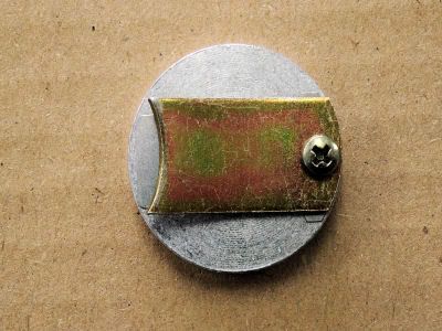

I'm getting oil in the square airbox which ends up on the bottom of my left carb where it drips onto the shift lever and my foot on my 03/1980.  I have the old style breather: Circlip washer spring washer and fiber plate.
The assembly is pressfit into the case next to the starter.  Has anybody change this out for the new style reed breather.  Will this fix the problem or am I chasing my tail here and need to look elsewhere?
If this is the right direction, what is the best methord for getting out the old breather and putting in the new?

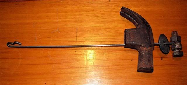

Changed mine out on the 90 for the reed conversion;
Did this by rigging a crude slide hammer and hooking it under the spokes of the old poppet valve. Did this with each spoke in turn till it worked it's way out.
Bill..................;-)

Bill  :D  That is inspired.  And I have a hammer head just sitting on my workbench!  Did you heat the case first or just give it a whack or four?  Darn - I don't think I have a heavy enough spoke.  Time to go to General Hardware.

Sorry, but no :( the new valve will not solve the problem. We all deal with it, regardless of valve type. On my bike (with older style airbox) the oil doesn't make it as far as the carbs, but rather drips down the sides of my tranny.
The best solution I have heard of is to put a bit of material inside the breather housing to give the oil something to condense on, then it will drip back down into the engine. I've heard a metal pot scouring pad suggested, or any metal mesh will do (although I'd stay away from something as thin as steel wool, I'd think the thin bits of steel might break down with the heat and end up in the intake tract.)
You may have to go to the new style valve for this to work, however, since I think that the older valve might be impeded in it's operation by anything in it's housing space.
It was a welding rod I used, and though I applied heat to the area with a heat gun, I felt the heat sinking ability of the case made that a pointless exercise. It was barely above ambient when I pulled it out, though I've heard others have used heat from a flame, but it still came out without problems. The spokes on the old valve are pretty robust for all intents and purposes.
The only reason I changed it was 'cos I could and the reed replacement is cheap, and also it gets rid of the turkey gobbler sound at idle. Anybody want a perfectly serviceable poppet valve???
Ignore the fancy hook shape at the end, it was just me bending frantically a strong piece of rod that didn't want to bend too easily, into a shape that would fit the spaces between the valves spokes, and that's how it ended up!! LOL
