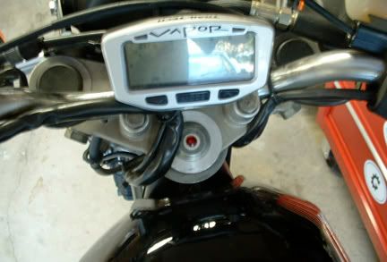

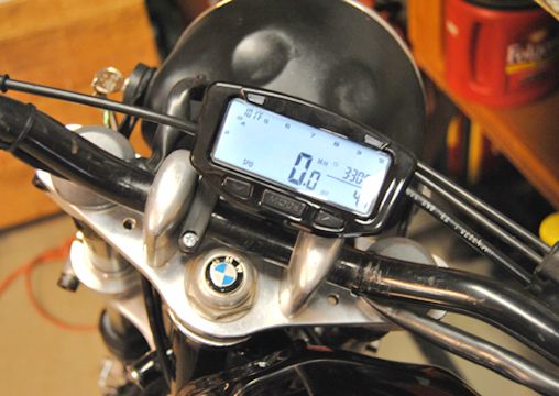

Digi TrailTech on my 1981 R65 and 1978 R100S. Easy hookup with only three small gauge wires, one of which is not used on the Airhead.
1983 R65 has a digital Acewell with the fancy little plug that replaces the OEM transmission cable and boot. Not a terribly difficult wiring install; just follow the instructions after reading through them at least twice. The Acewell looks rather period correct but you will have to pay more for that than with the TrailTech.
First photo is R65. Second R100S. Acewell photo presently AWOL.
