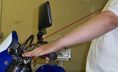

The angle of the reservoir never does seem quite right but that is way too far forward. As Bob said you can rotate the whole assembly backwards.

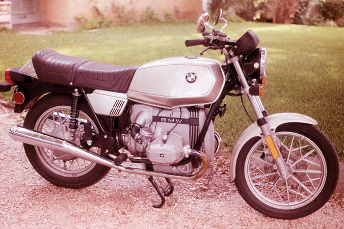

The optimum angle of the brake lever is supposed to be an extension of your arm. First pic shows the clutch side but you get the idea. And another pic showing something like the correct angle of the brake lever even though the reservoir is still not quite level.
