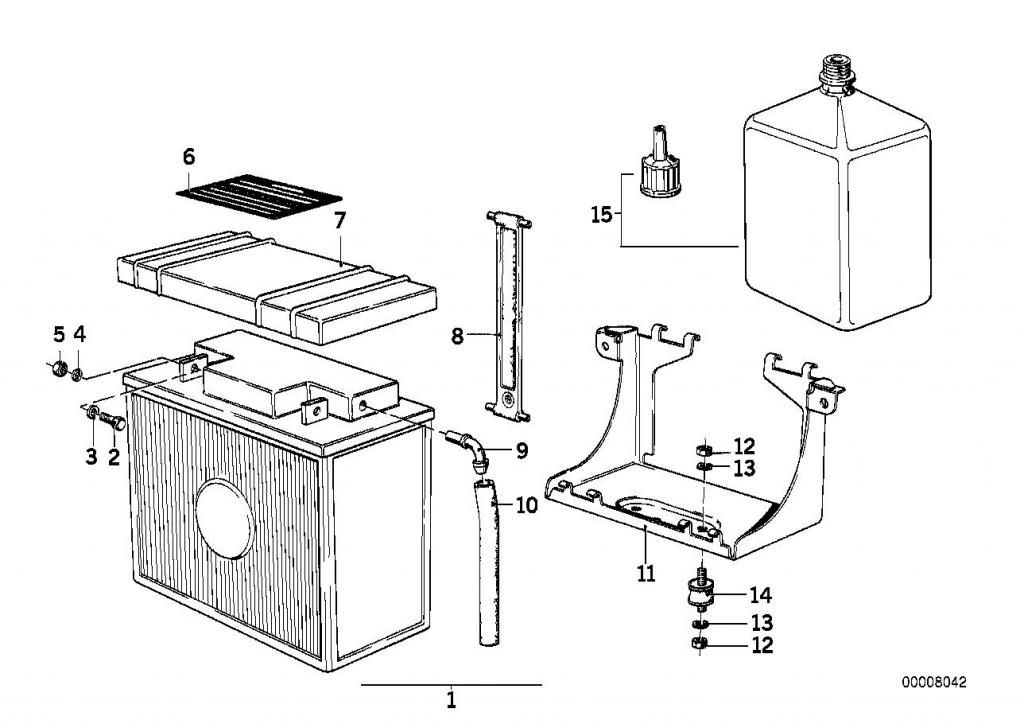

Morning All
Just working through my new (to me) 1983 r65LS.
The battery is wedged in fairly tight into the batter box but there are no retainers holding it in so m assuming there are the usual pain in the ass bit missing from when the batttery has been off for charging.
Has anyone got a picture of what retains the battery into the box so i can look about and order the bits.
Kev
Re: battery Box retainer
« Reply #1 on: November 24, 2014, 05:02:48 AM »
Kevin, part number 8 in the diagram is what you need. It is a rubber strap with metal pins in the end. They are no longer available from BMW but a lot of different bikes use the same method and it is possible to find one from a different make that will fit.

« Reply #2 on: November 24, 2014, 09:52:33 AM »
ah cheers, makes sense of the various hooks on the holder now!

The rubber battery hold down straps -#8- are available from Bob's BMW here in the Colonies. You'll need two of BMW # 61 21 1243562 at $11.72USD. http://www.bobsbmw.com/
I would recommend confirming the plastic battery cover -#7- will fit your battery before springing another $11.65USBucks. My two R65s do not need caps as they are sealed AGM batteries and have no vented filler caps nor do they require topping up with distilled water.
I also made my own battery hold down by using some small diameter bungee cording purchased at the local hardware store. Couldn't justify the OEM prices plus shipping.
