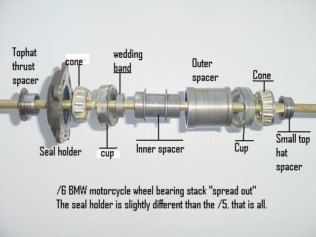

1st pic I don't recognise the top 2 parts. 3rd item is the inner spacer.
2nd pic shows inner spacer wedding band and top hat spacers
3rd pic bearings and seals.
If you ignore the seal holder and turn around the left hand top hat spacer this picture from Duane Aushermans web site shows the order.  You will also need to research and understand how to set bearing pre-load. Many of us here could describe that but it's a lot or words and Mike V has an excellent write up on wheel bearings if you can find it with a search.

The principle is simple enough.  The outer races are held in the wheel at a fixed spacing and the inner races have an adjustable spacing by the combination of the inner spacer and wedding band. The objective is to provide a slight amount of preload on the bearings when the wheel nut is torqued up. Wedding band spacers are available in .002" increments to make adjustments.
Judging the correct preload is the tricky bit. There are two ways of going about it.
There is the shake the wheel test which involves torquing the wheel nut while feeling for when all play disappears.
The more scientific method is to torque up the wheel nut and then measure the bearing drag with a spring balance.
Either method will work just fine.
Here is just one of many previous threads on wheel bearings. http://www.bmwr65.org/cgi-bin/yabb2/YaBB.pl?num=1376853636/

If you follow Duane Ausherman's diagram (with my caveats) it's hard to go wrong. About the only variable is which side of the inner spacer you fit the wedding band and or shims and that doesn't matter from a functional point of view. They were traditionally fitted on the left side at the factory so that's where I put them.
I would choose the pre-load setting method on this basis. If you understand exactly what's happening with the pre-load then in my opinion the shake the wheel method is perfectly fine.  If you are not sure the axle torque method is going to be safer.
