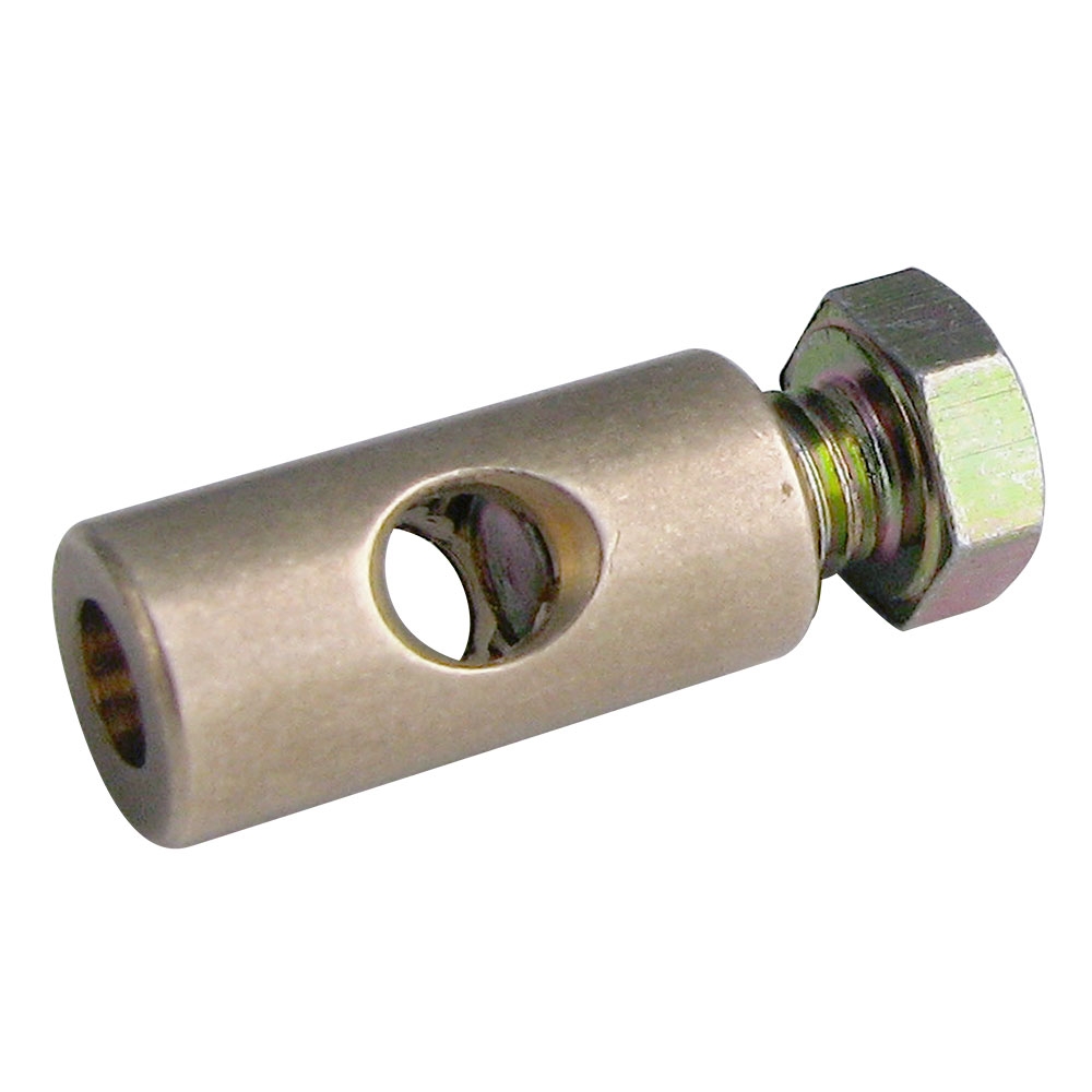

Steve, did you add this sort of thing to the end of the cable to attach it to the carb?
1981 R65 (box of bits).
Re: Hand control options
« Reply #9 on: July 02, 2014, 10:23:29 AM »
Not quite.
The hole was on the bolt and not the nut.  However, you might get that to work as well.
Rev. light

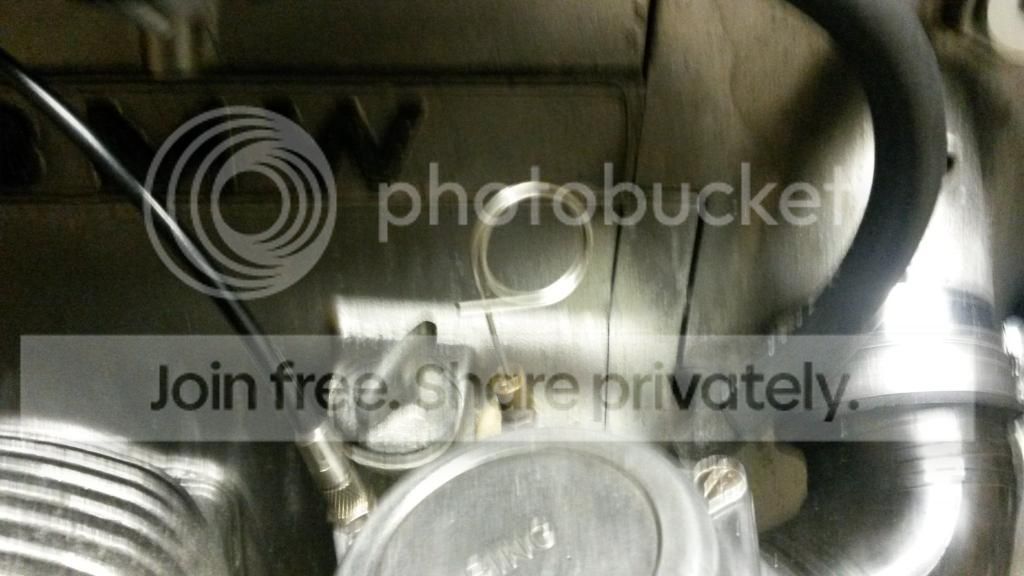

« Reply #10 on: August 05, 2014, 04:54:48 PM »
I made some choke pulls out of 1.5mm diameter stainless steel rods. coil one end a couple of times around a pipe, and hey! cheap and super simple choke pulls.
Sorry for the incredibly shaky and crappy photo quality, but you get the idea

I like that idea. Might use that on mine.
How did you attach the other ends to the choke?
arvo92
« Reply #12 on: August 06, 2014, 06:02:40 PM »
I had similar ones before I turned back to original system. The end of the wire is just put through the choke pull lever and turned into U shape ending. Nothing tricky, pure mechanics.

James, as Arvo said, just thread the rod through the choke pull lever, and bend it upwards. Works a treat.
