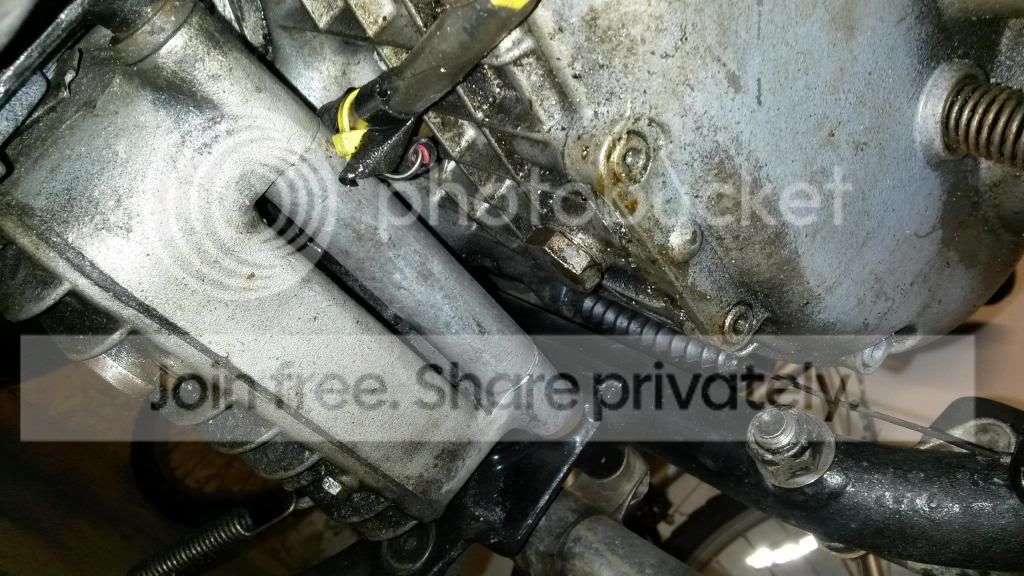

3. Discovered a small pool of golden coloured oil under the bike (been standing for 3 days). Oil is dripping from the nut at the bottom of the gearbox (you can kindof make out a drop forming on the nut in the photo). The location makes me think it's gearbox oil, but the look and touch of it seems more like engine oil - although no signs of leakage from the sump drain plug.

That oil in the picture is probably not coming from the gearbox cover, but you will have to clean things up under there pretty dry to be able to tell where it is coming from.  It seems like oil blows all over under there if there is a leak.

You should be able to tell if the oil is from the gearbox or engine by the difference in smell with gear oil usually having a distinctive odour.  Likely culprit is the neutral switch visible in your pic.

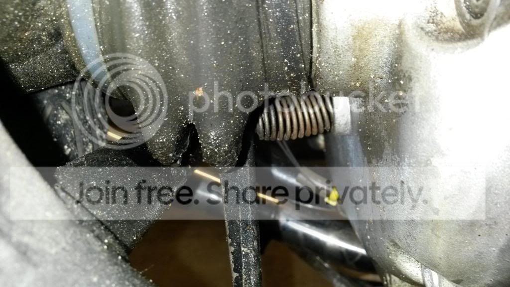

Looking for more than a few minutes, the leak is quite clearly coming from the swingarm to gearbox rubber boot.
The boot is horrendously swollen in two spots, almost certainly porous there and the zip-tie has come off.
From what I know about the replacement procedure for this, this is not a one man, standard-tools job. Any advice?

As to that zip tie on the diff's boot... that may very well be your leak source. There should be the proper metal clamps on both ends. What occurs with a Zip is a small, unclinched spot right where the strap passes through the locking portion. You'll never get it snug enough to stop weeps, seeps n' leaks.

Changing the driveshaft boot can be a life changing event.  ;) No, not really, but it is necessary to detach the swing arm by removing the bearing pins and then separate the u-joint from the trans drive flange.
Properly orienting the new boot and getting it onto the seating areas -front and rear- usually results in several choice words and perhaps a wee bit o' blood. Then getting the metal bands to meet and threads engaged, well, more words.
New u-joint bolts -the short versions- are installed without washers and should be torqued as close to spec as you can get 'em.
Suggest you invest in a shop manual. Haynes or Clymer or both; as each manual has a few errors that the other can help explain away. Study the entire process and take your time with the boot install. Accidentally poking a hole in the new boot with a small screwdriver is an unhappy event.
Try the correct metal clamp if you wish. That's a quick way to discover if there's a hidden tear in the old boot or the zip tie was just a quick qhetto fix that didn't work.

4. The oil that is seeping from the swingarm rubber boot is indeed gear oil - it does not smell as strongly I thought it would, but a smell test comparing it to engine oil leads me to believe it is indeed gear oil. The large excess of oil in the gearbox could explain why this is ending up leaking from the inside of the boot out.
