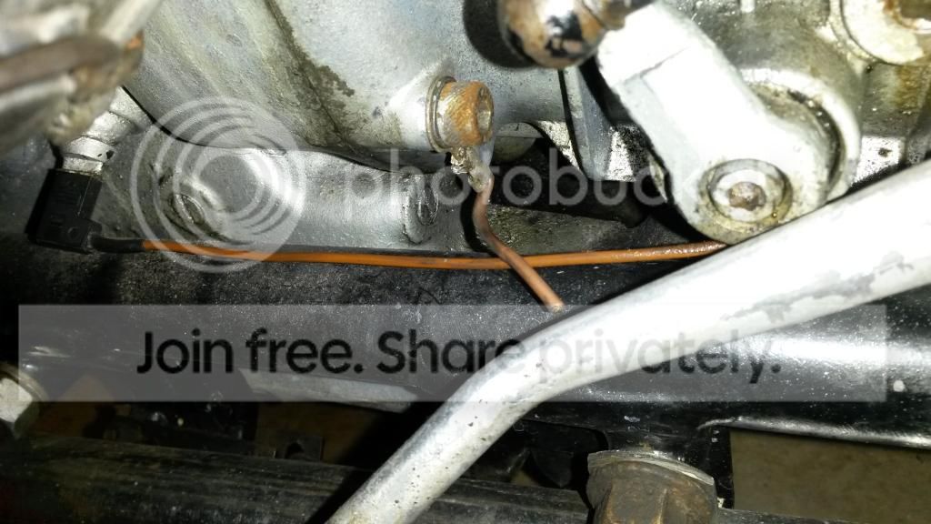

As I was toothbrushing the years old muck from the bottom of the engine, I discovered a lone wire on the left side of the engine (pictured). I am assuming due to its location and colour that it is an earth connection. It also looks like it has been deliberately snipped, not accidentally torn off.
What is this wire, and what should it be connected to? All the electrics on the bike work fine so I am wondering what the purpose of it may be.

You and me both.
Could have been an aftermarket accessory, that is no longer fitted.
Or a workaround for an issue that is no longer an issue.
Why they could not have just undone a single bolt instead, is beyond me.

Having said that I have one fitted to my R100.
 :D
Let me look at my circuit diagram and get back to you
Rev Light
Re: Rogue Wire
« Reply #3 on: June 05, 2014, 03:08:40 PM »
It might be from your neutral switch, or even your oil pressure switch.
You need to get a manual and look at the loom section leading down the frame tube to these switches.
It might be earthed somewhere else, as your neutral light is working?

« Reply #4 on: June 05, 2014, 03:33:02 PM »
You guys made me curious enough to get myself up and walk to my garage in half 11 pm as I knew I had the same wire but connected.
The wire comes from the same tube as the neutral switch indicator two wires do. So one black hose has 3 wires in total and this one on the picture is the third one.
As Steve mentioned before - do you have the neutral switch indicator light working on the clock?

Arvo, the wire you mention that comes out of the same tube is the one that is pictured, but connected. So I have 2 wires to your one.

Hello !
The torn wire is the grounding for the neutral switch on the tranny.
The oil pressure switch does not, normally, get a brown wire on it (as it gets it's ground from the engine case to which it is bolted).
The two wires, one from the neutral switch and one from the pressure sensor run along the frame to the battery box where there is normally a small connector to get them back into the main wiring harness. This small harness is still sold new by BMW and not so expensive. But maybe you lack the small connector too...
So your wiring had been messed up .....  :-[

I've got one of those ground wires as well - the intention is that the German engineers didn't want to rely on the anodized surface of the engine block and the gearbox making a good electrical connection, or rely on the bolt threads that hold them together to carry current.   In many instances, the wire is redundant in functionality, though from a purely electrical perspective, it is/was the *proper* way to ensure ground commonality in the electrical system.
