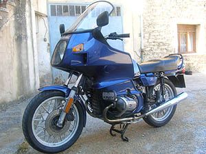

Some BMW sources mention a few of these R65RTs showing up in the US.
This is a 1983 R65RT registered in Spain. No twin disc front end. Nice looking scooter.

I've got it !
Enjoy !  :D

Monte,
That Spanish bike looks very nice in that colour and with the RT fairing.
I really like the look of the RT and the fairing suits the smaller frame 65 well.

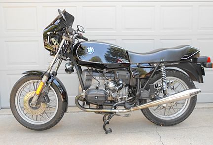

Would an 'S' cockpit fairing assist in reducing wind fatigue on a longer run Monte?
I really fancy one on mine with some bar end mirrors.
Absolutely!
After four days and one night in Alabama, "Crunch" Crenshaw and I were making one last quick pass through the massive swap meet area at Barber Vintage Days when I spotted a bargain on an almost new sporty fairing. Quick measurement proved it would fit the smaller headlamp on the '81 R65 so it, and a buncha other treasures, made the eleven-hour run back to Texas with us. The dark tint windscreen sealed the deal.
Tossed the one-size fits all mounting hardware, bought some stanchion-mounted headlight brackets, fabbed some small brackets that utilized existing R65 mounting points and now have a sport fairing that does a good job in knocking off the wind. Tiny, streamlined LED turns sigs eliminated the big ones up front.
