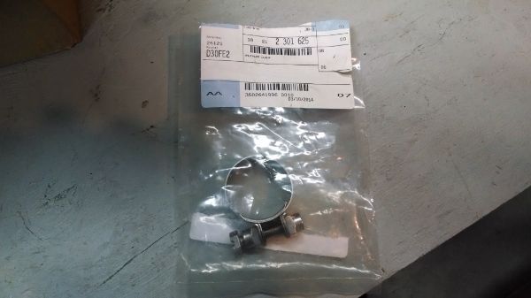

I recently bought a pair of clamps from Max($18 each!). I can snap a picture if you'd like.

« Reply #5 on: May 01, 2014, 09:12:21 PM »
A pic would be great.  Just can't seem to get them to snug down on these aftermarket pipes.

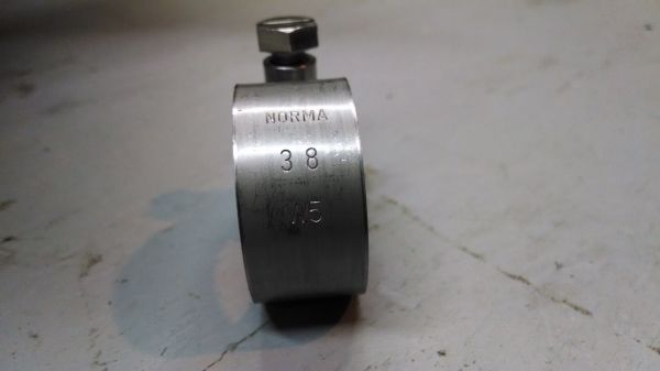

« Reply #6 on: May 02, 2014, 06:27:54 AM »
Here ya go...

« Reply #7 on: May 02, 2014, 07:36:00 AM »
If memory serves, I think the "38" is the maximum useable diameter, in millimeters, that the clamp screw will support. I have an extra clamp which I ordered that turned out to be too big.

« Reply #8 on: May 02, 2014, 07:53:39 AM »
A shade tree solution to the too large clamps is to cut shims from an empty aluminum can of barley juice.  Easy to do with metal shears and the preparation of raw materials can also be satisfying.   [smiley=beerchug.gif]
