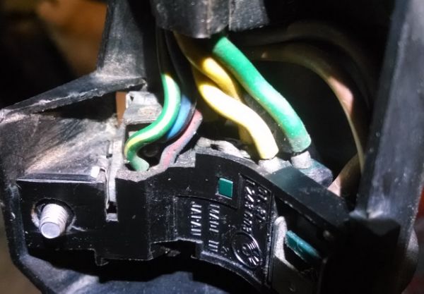

Not sure how helpful this picture will actually be, but...
In the middle of the pic is(I believe) the connection between the two high beam "modes". It's a bit of bare wire between two soldered connections. You might see if everything looks solid there.

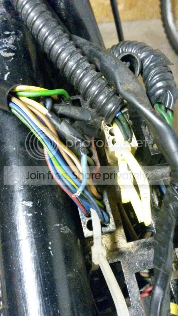

Right. So I finally had time to have a look at the problem. It is not in fact the switch (hurray for not having to take that apart).
The problem comes from the wire that is not connected at the plug under the tank.
As you can see, the blue (taped to the yellow) wire is completely removed from its location in the plug. When I touch the wire to its mate in the plug, the hi-beam does come on.
I've checked the plug and that position is missing the connector that all the other holes have.
My question now is, what is the best way to secure the wire back into its position without having to dismantle the entire plug (if at all possible)?
Re: Newbie - Hi-Beam Problem
« Reply #29 on: April 24, 2014, 01:44:23 PM »
With some ingenuity it's possible to replace the electrical connectors in those blocks. There will be little sprung ears that can be depressed in order to release the connector but you are going to need a spare connector from a donor block to crimp or solder onto the blue wire.
