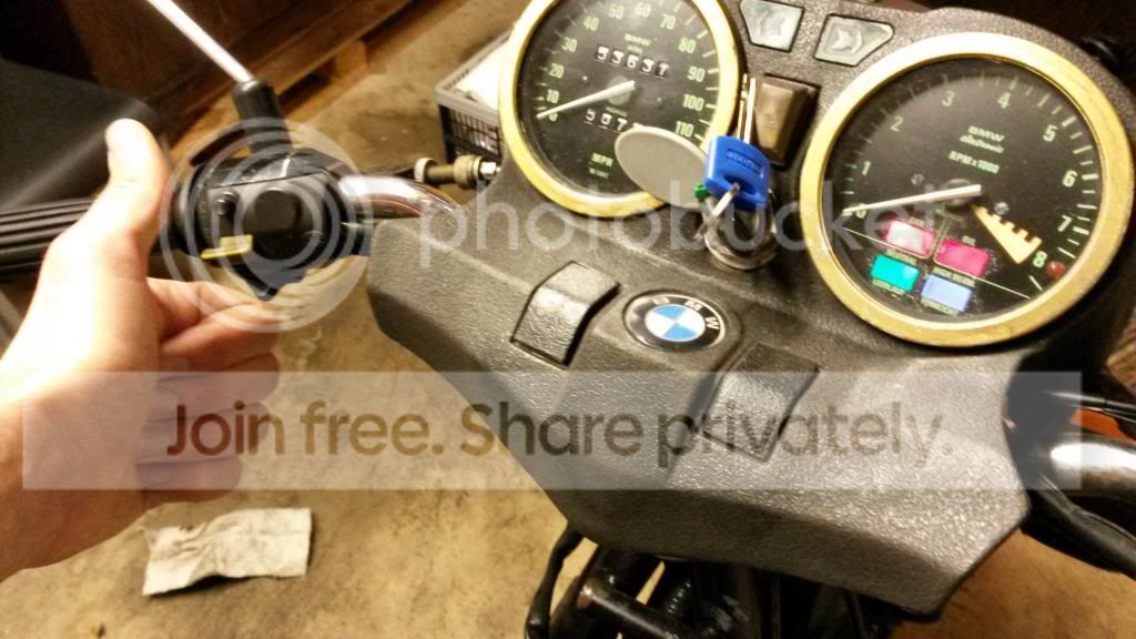

Woo! To the right of the photo, you will see I have Hi-Beam!
The terminal was still in the plug, and in pretty good condition after a bit of cleaning, so I removed the botched wire, and soldered on a new wire end, and that to the terminal. Easy as..
