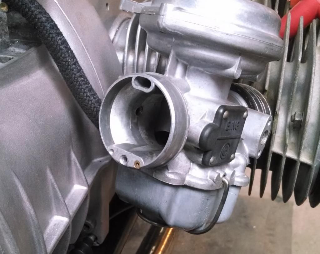

So I got my bike running. The left side barely runs, however. What's odd is what happens when I put my finger over the brass inlet port shown in the picture below. I believe it's the idle circuit inlet, am I correct?
Anyway, when I block that port on the right carb, the bike dies almost instantly. When I block it on the left carb, in 2-3 seconds that side starts running, and the idle speeds up accordingly.
I'm trying to make sense of this by looking at the Bing manual and what I can find online, but I'm still stumped. I've cleaned the carbs twice, and blown out all the passages I can find. New floats, float needles, needles & needle jets, idle jets, mixture screws, diaphragms and all associated rubber parts.

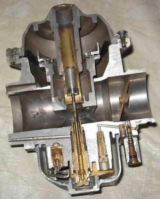

As Mike V says you have to make sure the whole idle circuit is clear but to explaining your symptoms this would be my take on it.
The brass jet is the idle air inlet. When you look at the idle jet itself there are a number or peripheral holes which is where the air enters and mixes with the fuel passing up through the jet. This rich emulsion of air and fuel is then diluted by the air coming under the butterfly before entering the engine  If you block the idle air inlet the idle mixture seen by the engine will go richer.
Your symptoms would then suggest your left carb idle mixture is too weak as reducing the overall air supply makes it run. Your right carb is less obvious, it could already be so rich that additional richness causes it to stall or it could be the throttle stop on that side is not open enough and the reduction in overall air supply is enough to stall it.
It's interesting that to make for an efficient carb both the idle circuit and the main jet circuit on the carb have an emulsion air inlet to promote better atomisation by pre-mixing air with the fuel before it gets to the venturi. In no case is raw fuel on it's own dumped into the venturi to atomise best it can. So if either of those emulsion air supplies are blocked (and that's not so uncommon thanks to gunk ingested from the engine breather) the carb will run rich.

I thought the right side dieing when blocking the port was correct operation. Hmmm...
On both carbs, I have used copper wire to clear both of the tiny holes by the butterfly. The hole closest to the center, I can only get about 1/4" down, the other hole I can get into the mix screw orifice. Same on both carbs.
I dismantled both carbs yesterday, all the o rings are undamaged.
I didn't try silicone grease on the screw, I'll try that.

Yes I guess you could say that. The idle should at least slow as it's losing some of the air. Not all of the air though as there is still some coming past the butterfly.  The air going through that air jet is only the pre-mix air.
That's normal. the two tiny holes behind the butterfly are the transition or bypass holes. They are connected to a little chamber (#5 on the diagram) so a cleaning wire will only go so far.  Worth cleaning them but they are not active at idle and only flow when the butterfly is opened a little.

Think about what you have do to make an engine idle at the correct speed.  The idle stop screws have to be turned in by something like 3/4 of a turn. That means the butterfly is open slightly not much but it is open, so a little air must be passing through the main venturi and the engine will not idle without it.  The little brass jet at the inlet is only the pre-mix air which forms an emulsion in the idle circuit and helps to atomise the idle mix when it meets up with the air coming through the venturi.
Like I said above in no case does neat fuel enter the venturi, it is always pre-mixed with air to give the best chance of good atomisation. The main jet circuit works exactly the same way in principle in that the main air supply comes via the venturi and butterfly but there is also a path for pre-mix air which is routed to the area around the emulsion tube that sits on top of the needle jet.  The diagram I posted above illustrates the main circuit pre-mix air supply clearly. The idle circuit air supply is less obvious being the dot and dash line just above.
If you want the definitive description of how a Bing CV carb works read the attached document. On page 1 the first paragraph of the right hand column deals with the idle circuit and explains the two sources of air at idle.

I'm getting a better understanding of how these carbs work. I'm still wondering what is happening when I plug the idle air inlet.
In your diagram above, the dotted line must represent the idle air inlet, which goes to the top of the idle jet. So fuel and air are drawn by vacuum to the small holes by the butterfly.
When I plug the inlet, is it then creating more vacuum at the idle jet, and  and therefore drawing more fuel thru the idle jet?
Yes
Not the two small transition holes they don't flow at idle because there is insufficient vacuum above them. Look carefully at the position of the transition holes they are behind the butterfly at idle and they only flow when the butterfly opens slightly and is positioned directly above them which increases the vacuum.  The purpose of the transition holes is to smooth the transition from idle onto the needle jet. At idle the mixture only flows through the idle outlet which is the one controlled by the idle mixture screw.
When I plug the inlet, is it then creating more vacuum at the idle jet, and therefore drawing more fuel thru the idle jet?
When you plug the idle air inlet you are eliminating the pre-mix air so only neat fuel is drawn through the idle outlet. It may draw more fuel through but even if it didn't the overall idle mixture would still turn rich.

well, I found the problem, or at least A problem.
One of the two tiny holes directly under the butterfly is plugged, I didn't even realize there were 2 holes there until I looked real close with a magnifier, then looked at the other carb to compare. The blockage is the same color as the aluminum carb body.
The blockage is very hard, almost like mineral deposits from hard water. I don't want to pick at is and risk enlarging the hole, so I'm soaking it over night in Pine-Sol. Hopefully that will soften it enough that I'll be able to clear it with a copper wire.
