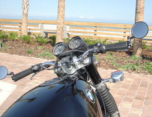

Additionally, how do you tell the difference between low bars and high bars? i have the ATE calipers if that makes a difference.
Re: Front Brake line upgrades
« Reply #2 on: April 04, 2014, 02:15:04 PM »
This is not an R65 but these are the Euro low bars. The USA market high bars will have a 2-3 inch rise. Euro bars place the rider in a sporty position while the high bars provide an upright seating position that's terribly uncomfortable bucking the wind blast at a 60+ mph cruise speed.
