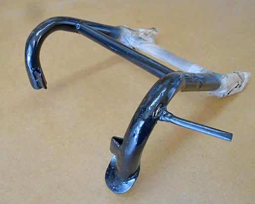

I'm now ready to tackle the R100S tube seals. Only one is 'seepy' but it really would be penny-wise and pound-foolish not to do all four. As long as I've pulled the exhaust system, I may as well detach the worn center stand and cart it off to Hoop's, my favorite machine and welding shop in town.
    I'll have them build up weld on the terribly worn spots, then I'll spend some quality time grinding and shaping and making a huge mess in the shop.   At the frame-to-stand contact points, everything looks like new. Lucky there.
This photo ought to explain why the R100S is so hard to get on n' off the center stand. Dat's sad. In a couple days, I'll post up a photo of the repairs. Now, on to the tube seals...

There's a truism within the military community: No plan survives contact with the enemy. And so it went with my plan for a quick welding repair on the R100S center stand.
The antagonist was my usually attentive to customer service welding shop that sat on my job, untouched, for nine days. I now have a new favorite that completed the job with next day service.
The change in contractor was especially nice as the shop handled grinding down the weld build-ups and correcting the ground down, egg-shaped foot pad... all this done unasked. They even discounted the price when I showed up with a six-pack as a thank you for the prompt service.
The repaired areas look better than my photo would indicate. I also enjoyed one of their 16 oz "tall boys".  [smiley=beerchug.gif]
Now I'll add another coat of paint before reinstalling the stand. BTW, any tips on fitting those stout springs back onto the center stand's pegs?

« Reply #4 on: March 18, 2014, 10:43:34 PM »
Hello Monte,
On my '82 R65 putting the springs back is very easy provided you put the bike on the centre stand first. This way the springs are not extended (well only a wee bit) and it is an easy job.
I don't know the status for the big sister, though...
I can tell you what not to do: use a screwdriver to stretch the springs, then leave it in between as you take the bike off the stand.
Stand and spring still work fine, even though the spring looks a bit like this: >

Centerstand is on and the sprigs were no trouble when following geaogesgiralt tip. I did have to grind off a little bit of the foot stomp pad to permit the left-side leg to make full ground contact. Far easier to remove a bit of metal than to need more.
What a huge difference in the ease of putting the bike up n' down, on n' off the stand. [smiley=thumbsup.gif]
