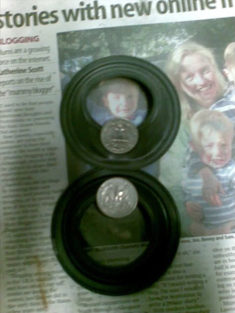

Behave the pair of you.....................................Steve I am seriously adverse to additives after my tests a few years back showing the impact on seals and "rubberized"  components .... its a no go area for me.

« Reply #8 on: January 31, 2014, 04:09:57 PM »
Lou,
I seem to remember you had a problem with the diaphragms. Was that caused by a fuel stabilzer ?

Been digging back through my photo bucket stuff...
#1 comparison between generic and Bing diaphragm...
impact of fuel additive on rubber/rubberized components....
I did have a photo of a piece of diaphragm exposed to additive which resulted in the material expanding by 30% in a few days but cannot find it at the moment...
