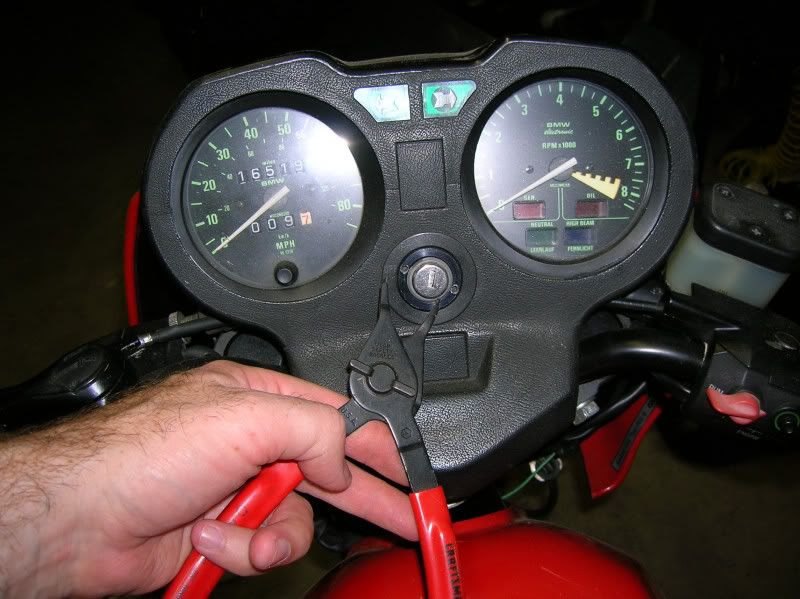

I need some help,
I bought a new instrument housing (or shroud) for my R65 and trying to take off the old (broken one). I'm talking here about the top part of the rubber housing (the one with the logo, see attached picture). I'm stuck trying to taking off the old one, since the black ignition switch ring is obstructing it (I'm referring to the black metal ring where the ignition states are engraved: off/parking lights on/on /on with parking lights/on full lights).
Question is, do I have to take off the whole ignition switch or that black ring unscrew or something.
Thanks for your attention.

there should only be a nut over that black ring and then it should come off. the ignition switch will stay mounted on the headlamp/instrument mount.

If you see (2) small holes in that black ring, then it is threaded and you just take a circlip tool (if you have one, if not,
see if you have a pair of needle nose pliers that willfit the tip of each part of the nose into one of the
holes... if you don't have one of those, try using (2) small nails (one in each hand) and rotate the ring
anti clockwise to unscrew it.  The ignition switch will stay in place.   I have an 82 R65LS model, which has this
little black metal ring - your model may be different, I suspect, in regard to this bit.

Thanks for your tips,
thanks nhmaf, I have those two small holes and actually I guessed they were somehow involved in the process. Thanks for the picture as I can see what kind of tool I do need (even if buying that just for this task could be quite expensive... I'll probably give it a try using something else as you suggest).

There are two little clips as well. That hold it on the bracket. Look underneath from the side & you can see them. You can release them easily with needle nose pliers, forceps or even pushing with a screwdriver. Check before reinstalling to see if they need to be expanded back to original state. So they snap back to retain the surround.
