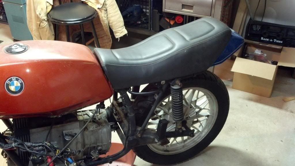

Thought I'd close the loop on this.
I bought an '84 seat and cowl. They fit without a problem on my '79. The hinges line up and the rubber feet rest on the frame rails.
I don't have the fender installed, the rear tray mounts to the fender, correct? The fiche only has one fender PN, so I think that'll be fine.
I also got a '79 version tool tray. Since it's taller, the seat won't close, butI don't see any reason I can't cut it down to fit. This tray was a freebie, and has a big hole in the bottom that was repaired with duct tape, so I don't have a problem with "modding" it.

... I don't have the fender installed, the rear tray mounts to the fender, correct?
Be sure to buy or fab the simple metal strap that captures the bolts as they pass through the fender. It's about 0.375" wide x length to fit. That may be it listed as #13... maybe not. The back-up strap prevents the mounting bolts from pulling through the plastic fender.
yep, got 'em for both fender mounting points.

It shouldn't be a problem mounting the box to the fender.
I don't know the details, but it should make itself obvious to you.
You may have to drill a couple of holes in the fender - I don't know.
