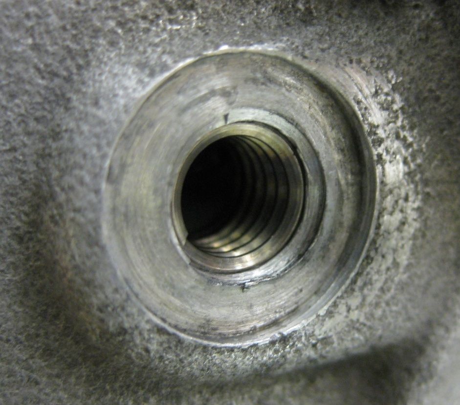

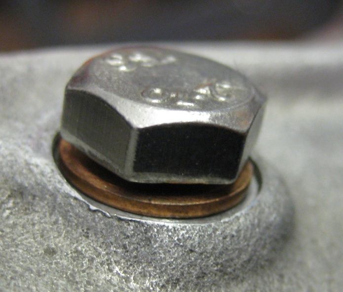

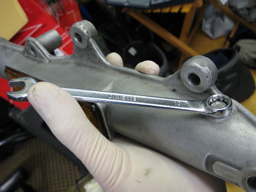

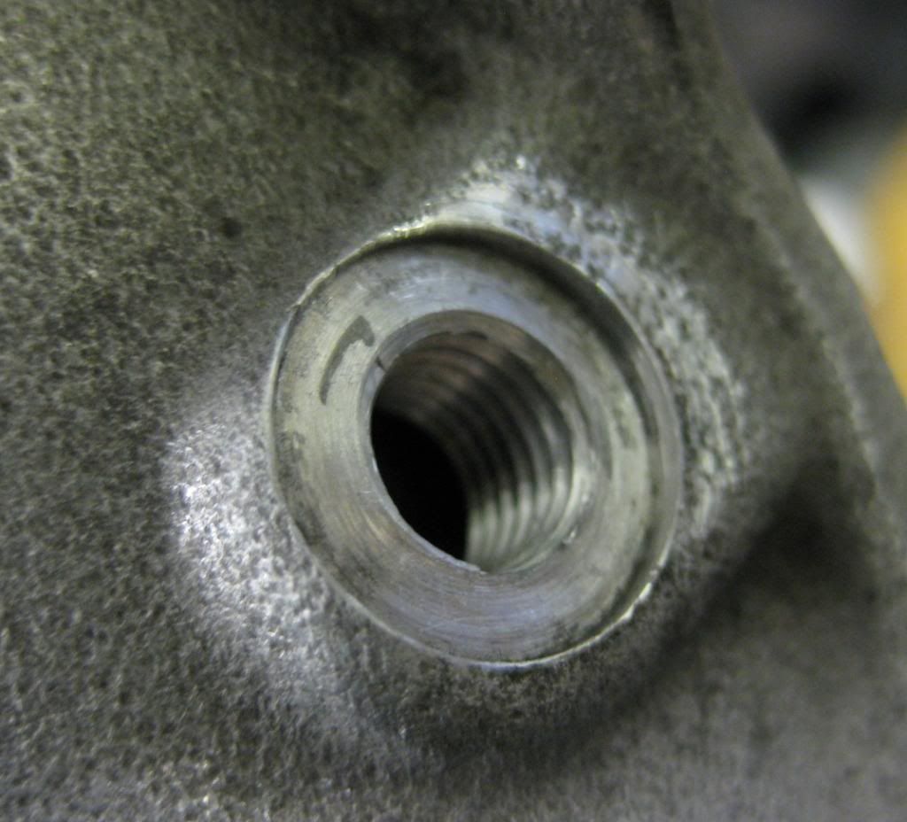

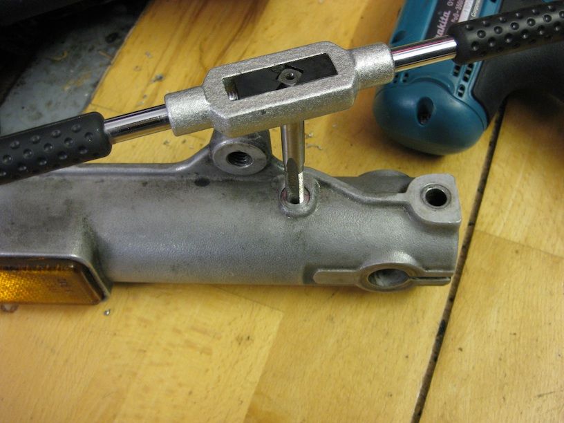

Some pics in case anyone has to do this job again:
(1) Drill and tap (M6 helicoil kit), with 5mm helicoils (I got from www.motorsport-tools.com)
(2) Tapped hole:

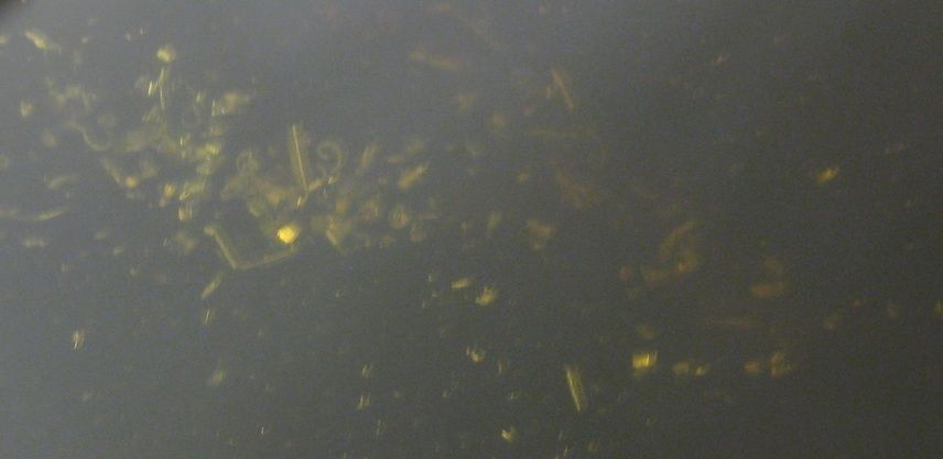

(3) Amazing amount of swarf to rinse out of the hole and slider (looks gold because its in oil):

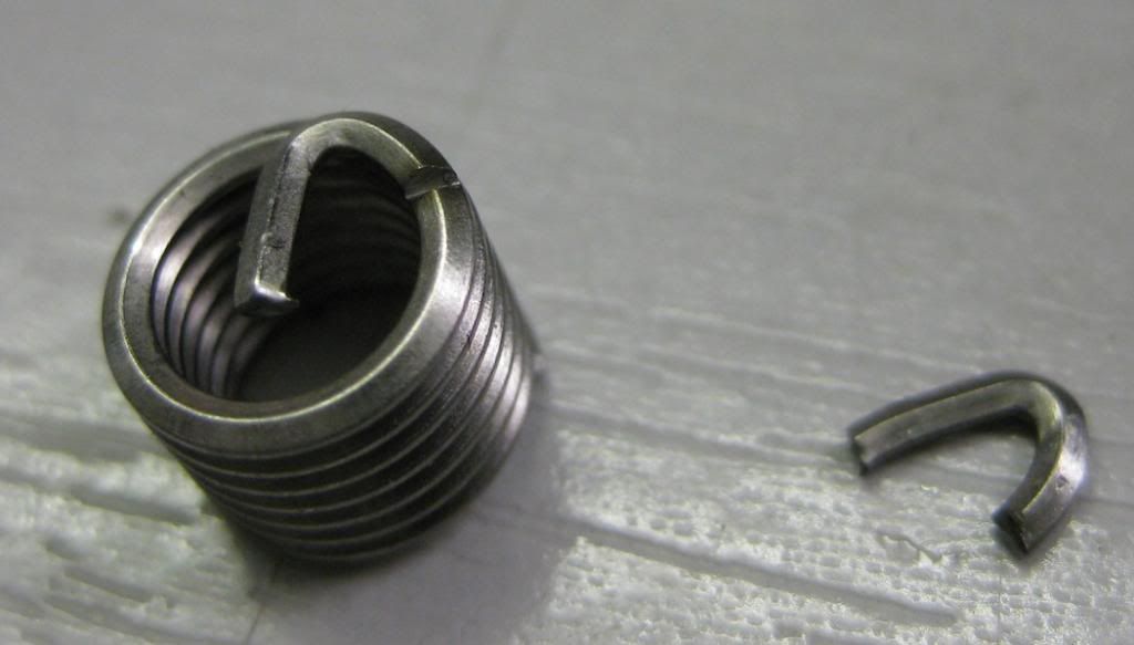

(4) Helicoil inserted, be sure to go flush or just below surface. I did put some lock thread on the coil and leveled off rough spots on surface (not yet done in this photo).:
(5) Break off the tang that you used to insert the coil and retrieve from slider!
(6) I went with a copper crush that I felt had a better surface area
(7) And the thing I will not forget ever again!, Just snug with the drain washer.
