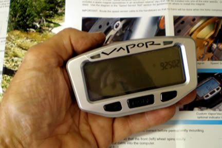

Numero Uno:  The vapor speedometer uses a rare earth magnet attached to the brake disc and a sensor fitted to the fork slider to calculate the road speed of the bike. After all is installed, it's necessary to program the unit, in millimeters, for the front wheel diameter. Instruction book makes this a no-brainer.
So, here's the instrument unit with my hand for scale.
Substantially smaller than the former steam gauge tach/speedo/instrument pod. I need to fab an aluminum mounting bracket as the Trail Tech offerings will not fit the Beemer. Handlebar clamp bolts are further apart than the Trail Tech offerings. I'll make my own from AC-grade aluminum. This job will be cake.

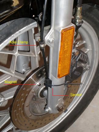

The rare earth magnet needs to be attached to the disc rotor. Trail tech provides a magnet/bolt combo that is unusable on the R65. Instructions say option #2 is to glue the magnet to the rotor. This install works fine using some aircraft-grade structural epoxy... just like Boeing uses to glue the skins to your favorite airline's tail surfaces and wing components. Good stuff.
Was necessary to grind down a small portion of the fork slider "stiffener" rib to permit the speedometer sensor to fit neatly. An Adel clamp routes the sensor lead up the fork leg and on to the instrument head. The zip-tie is temporary. A double faced stickie pad secures the sensor to the fork slider. I'll need to watch this for installation security.

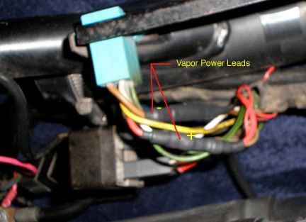

All wiring is small 22 gauge. The instructions recommend wiring to a power source that is not switch controlled. My R65 has an additional equipment plug with a 12v "hot" pin along with a ground pin. Used a couple of insulated bullet crimp-on plugs grafted into each wire. This keeps the equipment socket useable. The other end of the power lead has a very small two-pin plug that fits a lead off the back of the instrument.

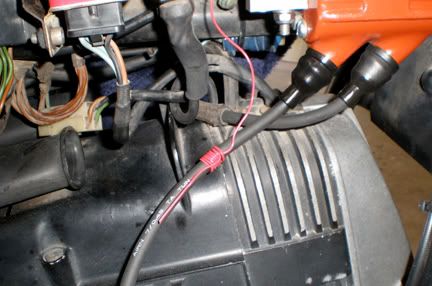

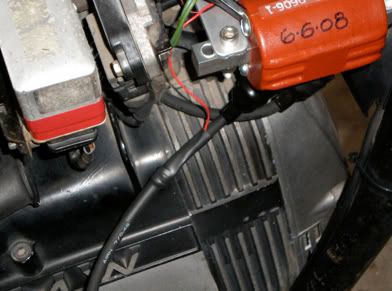

Last item is the tachometer lead. One of the two-wire lead must be grounded to the frame. The other 22 ga. wire takes about seven turns around the spark plug wire. I put the wrapping under the tank near the Dyna coil where it's out of sight and secured it with a bit of large diameter shrink tubing over the small wire wrap and spark lead.

This is the Special Equipment socket on my R65. I was able to tap into the 12v power and ground leads by using "bullet" connectors. The Vapor wires are so small they barely added any additional diameter to the existing OE wiring. Instructions encourage a power tap that is not interrupted by a switch.
The tachometer inductive wrap. Seven turns. very high-tech...
A length of large diameter shrink tubing cleaned up the install and will afford some insurance against the 22 gauge wire ever unwrapping. The tach wiring also requires a ground wire. I anchored mine to the nut on the frame bracket adjacent the diode board.
