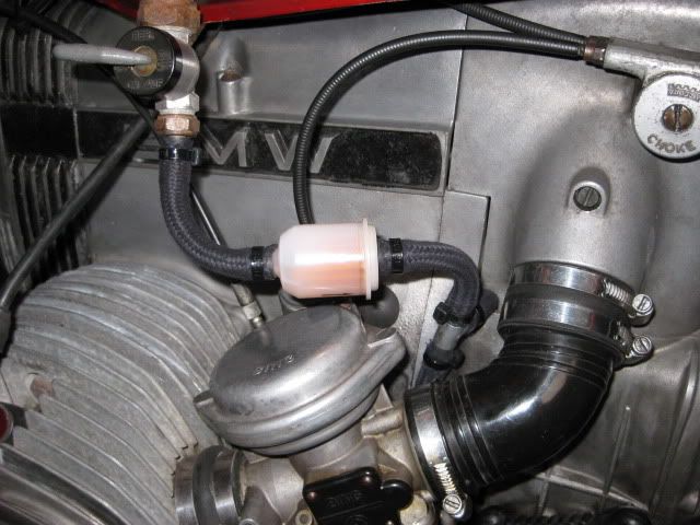

I'm about to renew fuel hose from the tee connector over to the RHS carb, using outside cotton braided hose to replace existing.
Looks like I might be able to slide out the old section and slide in a new one without removing anything, or am I dreaming?
also thinking about replacing the tee piece with a brass y piece to ease the angles for my inline filter, thoughts on this brainwave?
Mike

I stayed with the T in the end, The Y did ease the angles but its also brought the filter down to rest on the top of the Carb.
I bought extra hose so I could play around and try different lengths between the connection points, I think I have now managed to get the shortest runs, with nothing touching other parts, and no kinking.
I think a 3 o'clock tap is really the way to go on this, I assume they fit the earlier models ok?

Hi fdo, no my tank outlet is on the left also, I am just thinking of changing the tap to the type R65 Mark has in this pic, much better for the inline filter set up

OK, now I get it, I was somehow watching the picture the other way... I can see you mean the filter being vertically should be better... that makes sense... although mine ins horizontal and I never had a problem with it...

Yes, mine works good too, horizontal is fine, its just that the angles the bits of joining hoses have to go through can be a bit tight and there is a danger of kinking, and I think the side exit from the tap just makes the filter placement looks a lot neater, not hanging over the Carb top and blocking the view of the timing hole ( rubber bung in casing), like mine does right now.
But as you say, if it works, why worry,  :)
