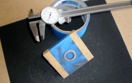

Yesterday I've found nylon washer to play with. I had to augment the size of the hole to pass the needle jet. alas the washer are 0.9 ~ 1.0 mm thick.
So I wonder how to thin them and get a couple of equal thickness... to shim each carb equally.
As yet, I've not found a way... So any idea is a good one !

0.8-0.9 mm will give you half way between two needle positions. I found 0.8mm was the maximum thickness that can be used because there has to be some shoulder left on the needle jet to centralise it in the atomiser.  Shouldn't be hard to rub 0.1-0.2 mm off on wet and dry abrasive paper.
I originally used 0.5mm thick red fiber washers intending to replace them with brass but I have never needed to as the fibre washers have been fine.  They are very easy to  rub down to the required thickness.

Having once had to "thin" a couple washers, I used wet 100 grit wet or dry secured to a dead flat plate.
To hold those little washers, thin, double-faced tape on a wood block worked well.
Sand in a Figure-8 motion to avoid creating a tapered washer; which I have also once needed.
