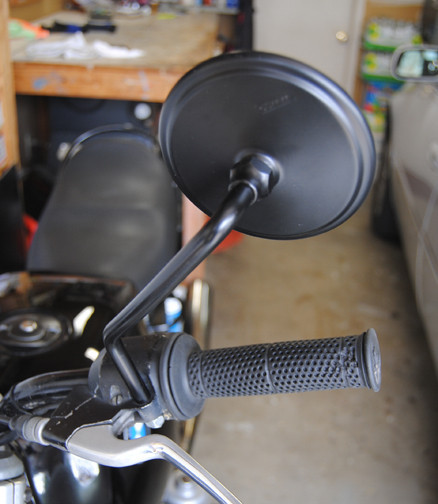

My 1981 R65 came with BMW OEM mirrors. All metal, short stem with chrome that was flaking at the handlebar perch attach point. No vibration but the nasty chrome lead to a pair of after market mirrors which I still have on both R65s.
The latest acquisition, an R100S, came with a single, universal, clamp-on handlebar-mounted mirror that was borderline useless; as the glass was positioned well inside the switch assembly. Had to go.
I searched multiple BMW dealer sites (pricey!) and accessory stores but did not find anything that met my needs until I crossed The Pond and checked in with Motobins. http://www.motobins.co.uk/
Their selection is extensive and I found what I wanted.
Here's where it gets interesting. The mirrors I purchased arrived promptly and I soon noticed they are from the same manufacturer as my old R65 mirrors - bumm-Spiegel and made in Germany. My old flaky chrome mirrors had the BMW logo along with the debossed name "bumm". I also recently saw a nasty pair of R65 mirrors on eBay and they were old chrome, as mine, and also had the bumm name.
The kicker is the new mirrors are exactly half the price from Motobins as the same mirrors from Bob's BMW.
Show more
Look closely at the 12 o'clock position on the mirror head. You may be able to spot the bumm impression.
Motobins offers both the short or tall stalk, chrome or matte black, all at the same price.
Details to note:
The mirror stalks have a non-threaded, reduced diameter where they pass through the perch. A self-locking nut secures at the bottom. Both perches on the R100S are approx 0.50" - 13mm thick so my mirror selection was #90430 (left) and #90431 (right) for the short stalk, matte black finish.
To utilize these same mirrors on the R65, the left side is #90430. However, the right side has a thicker perch - 0.875"-22mm - due to the master cylinder mounting requirements. The correct right-side mirror is #90433. This mirror has a longer reduced diameter shank. Both are secured with nuts at the bottom.
   The use of these mirrors will possibly require running a drill bit through the mounting holes to remove the threads. I had one R65 mirror hole that was already boogered up.
The Motobins price is $27.26 each / 17£. Bob's BMW list is $47.00+ each.
Royal Air Mail was $22.45 / 14£. US shipping would likely be around $10.00-$15.00 based on weight. Either way, the bottom line is I saved $30.00 and installed OEM manufactured mirrors. BTW, they work great with zero mirror buzz at any rpm.
Confirm all dimensions and mirror styles prior to ordering as YMMV from mine.

Nice looking mirrors and a bargain price for OEM quality.
I have the original Bumm mirrors.  They are near perfect but now you mention it I notice the beginnings of the chrome flaking at the bottom of the stem on one of then. Shame they didn't make the stems of 304 stainless like the heads.

... now you mention it I notice the beginnings of the chrome flaking at the bottom of the stem on one of then...
It's just a guess on my part, but I've wondered if the pressure generated during the stem tightening install doesn't create strong forces on the chrome plating that causes the plating to eventually give way right at the base of the stem -usually at the hard edge where the outside diameters change dimensions.
That's one of the reasons I went with the matte black finish. That and the overall black color scheme of the R100S.

I think you're right about the reason for the chrome flaking.
I've seen that the perch mounting (aluminum) tends to dish from the steel of the mirror stem. And then it's not held very tight and can change position fairly easily, or requires lots of torgue on the nut.
I used to find washers to protect the top side of the perch, but they'd dish as well. Something was needed that wouldn't dish and in that way also protect the mirror shaft.
The solution was hardened washers from the hardware store. They're not chromed or anything, but can be painted which works well enough.
