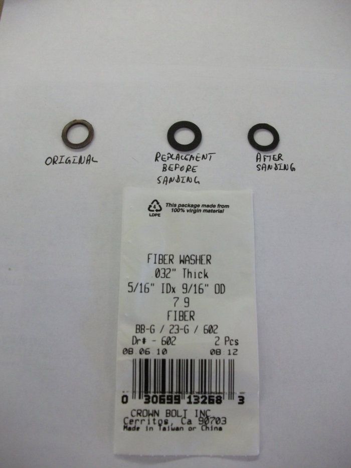

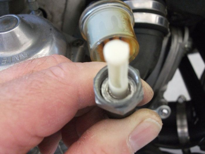

Anyone with a Germa fuel tap, the small fiber ring or gasket that goes between the 17mm nut and the tap body, the gasket or ring is no longer avaiable from BMW .
Found them at a home improvement store in their prepackaged hardware section .
They need a bit of outer diameter reduction to work properly .
Germa fuel tap, the fuel line comes out at the 6 o'clock position .

Got 'em at Lowe's home improvement .
Less than a dollar for two .
