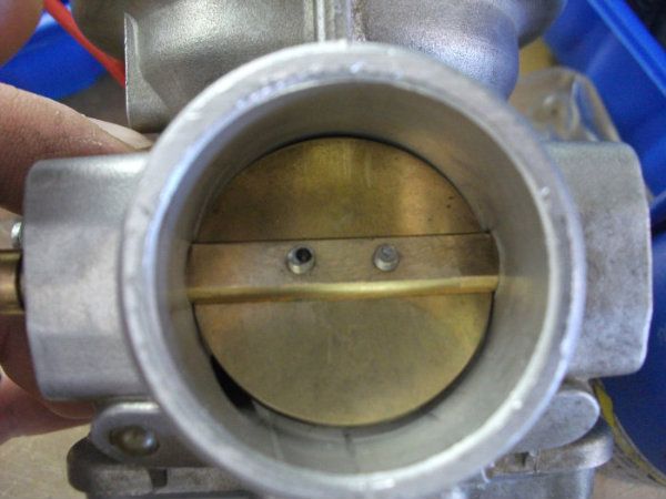

I found that a spring loaded automatic center punch does a quick job of peening, or mushrooming the end of the screw, got access to a rivet squeezer at work, but it won't fit in the small area of the carb throat .

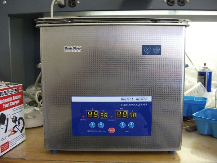

I've got an ultrasonic cleaner and I wasn't too impressed with the results, when I rebuilt the carbs on my '81 R65 about 5 years ago .
I even got a cleaner specifically for aluminum and all it did was darken the metal of the carb .

What cleaning solution did you use in the ultrasonic cleaner when you had discloration issues?  I use a 50/50 solution of Simple Green and water, then two 15 minute finish sessions with clean water only.

I used Branson IS concentrate .
I used a 9:1 solution .
I'll have to try Simple Green, only reason I didn't experiment with this, the manual that came with the ultrasonic cleaner cautioned about using 'foaming' type cleaners .

I picked up some Simple Green disassembled the right carb today and put it in the ultrasonic cleaner, give it 4 hours of operation and see how it looks .

Here's the ultrasonic cleaner that I got through work .
About 6 quart/liter capacity .

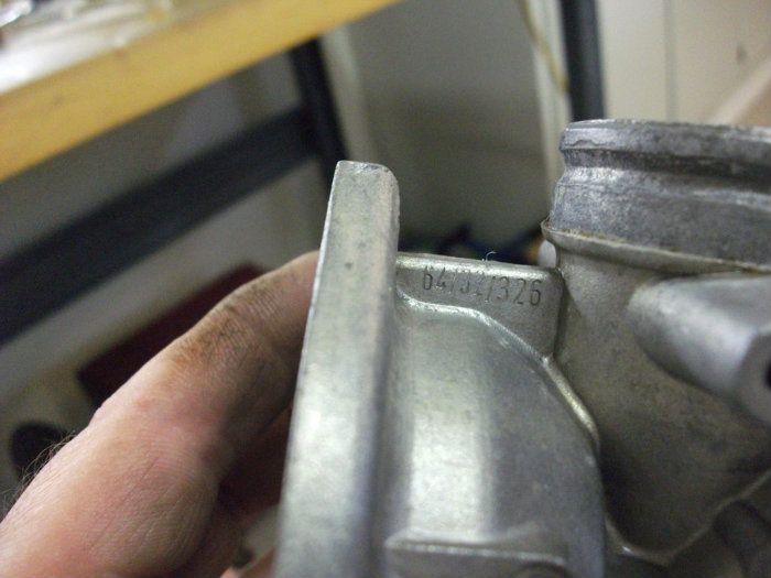

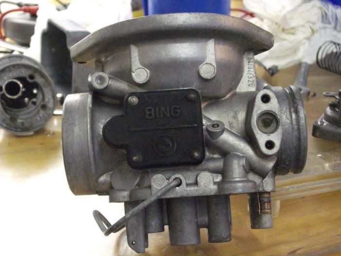

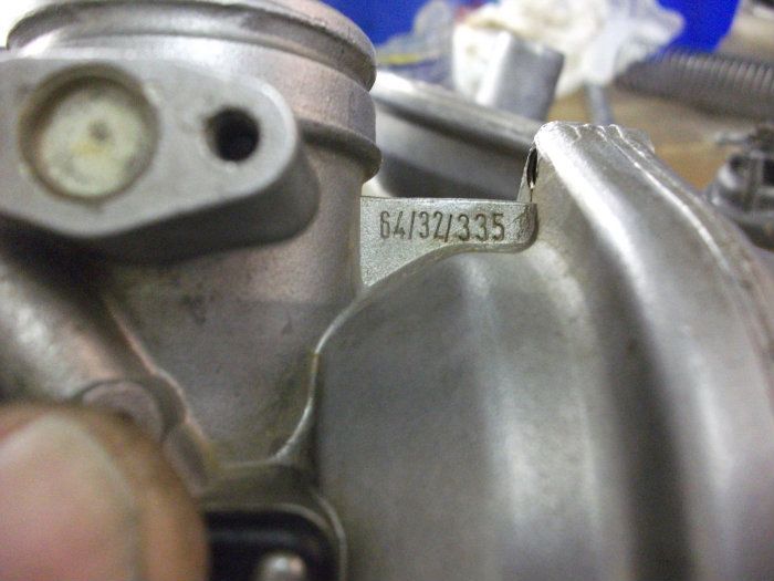

I found out why the carbs are in different condition looks/tarnish wise, I have a mismatch of carb bodies .
Number on this one, should have been 64/32/336, not/326 , or the other carb should be a /325 .

Looks pretty nice Bob.  Did you get the butterfly perfectly lined-up so there was no daylight showing through the venturi before securing the butterfly shaft screws?

Got them aligned with no problem .
One thing that almost caught me, was that I pushed the throttle shaft in too far, got the throttle plate lined up alright, but I couldn't get the bracket that holds the throttle shaft in to go into the groove on the shaft, the shaft was just a bit too far in, loosened up the screws pulled the shaft back out realigned the plate and all was good then .

Do not be too much concerned about the reference discrepancy between your 2 carbs. These numbers just specify a set of jets and needle position.
You are going to change jets, needle and needle jet so you can make both carbs the same as per functionality.
The body is the same and, as far as I know, the venturi is also the same.
The only drawback is the corrosion.... But in a month you won't look at it.

Looks like the 335 carb is currently correct for an a USA 82 R65.  The 326 isn't even listed. That's probably because it was replaced by the 336
http://www.bingpower.net/english/service/einstellblaetter.html
« Last Edit: November 02, 2012, 07:20:44 AM by bhodgson »

The information on the Bing web site is not accurate nor complete. My R65 1982 (European) is not listed. But the bike exists, I own one copy which is sitting in my garage right now  :D
I, for one prefer to ask the BMW maintenance manual or the user manual. In my case (I bought the bike new, in 1984) both give the correct information for jetting. And these jets where fitted into the carbs when I rebuild them.
Re: Carb Question
« Reply #14 on: November 02, 2012, 10:10:19 AM »
Yes the list is incomplete. My carbs are not in there either but the version for a later model year is.  It's still a useful resource to compare the fine detail between different carbs.
