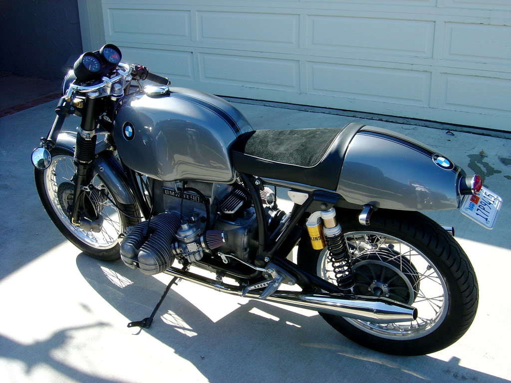

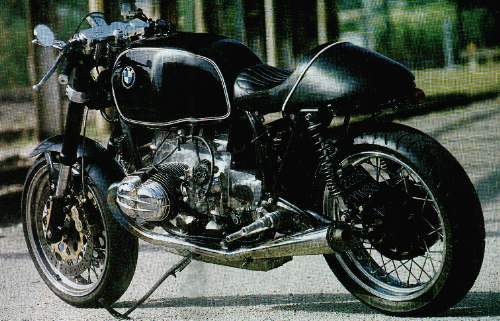

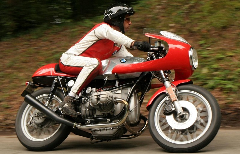

i think you should go cafe, if you want pictures of inspiration i can give you some!
