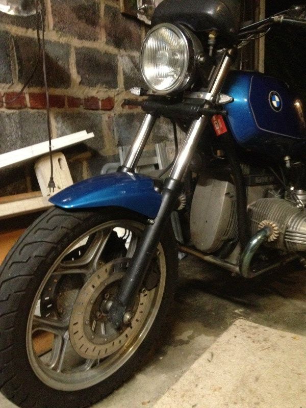

IMHO, the dual R65 brakes aren't worth the money, they are far too weak.  I spent about the same as it would cost to convert to dual R65 brakes and just swapped out the entire front end with a K75.  Bigger forks (41mm) and larger rotors.  Braking has increased by 1000%, I could probably manage a stoppie now if I had a death wish..  ;)

I wonder why the K75 front end would offer such a phenomenal improvement in braking since they use the same calipers as the R65?
Pretty neat conversion.  Are the forks the same length?  Assume you are using the K75 triple clamps?  How did you mount the headlight/instrument carrier bracket?  Does it just bolt on?

mrbindc
Re: Dual Brake Rotor Question
« Reply #12 on: September 04, 2012, 10:17:30 AM »
I had a host of issues to deal with when the bike arrived.
It had a single disc brake that was very weak and the forks were locking up.  It was scary to ride in DC traffic.
After pricing it all out, it was cheaper to swap in the K75 front end (and easier to find) than adding R65 dual brakes and rebuilding/replacing the OEM forks.
I used the K75 forks, brakes, triple tree and wheel.  Total cost was about $300.
The forks are longer, I have them up about an inch in the triple tree and used bar-backs to clear the bars.  The headlight bracket does not match up at all so I made an adapter this weekend with some alloy stock and used rubber spacers to get it mounted.  The picture above just shows the bracket zipped tied in place for the test rides.
Still waiting on the rear section of the front fender to come in from a fleabay seller but I'm pretty happy with the swap.  With the heavier front end, it is a lot less twitchy at high speed and the brakes are great.
I can add more pictures if you guys want to see the finished product.
