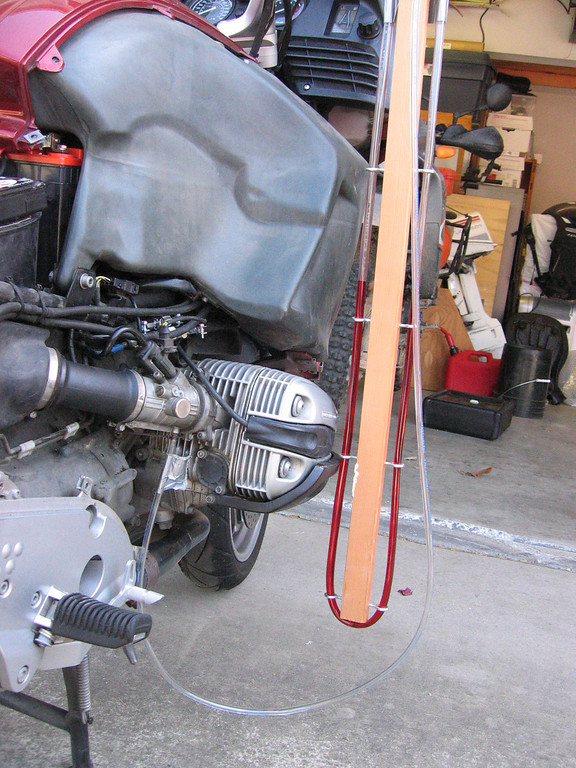

I and many others use a home made yard stick manometer filled with ATF.  Anything you can buy is unlikely to be as sensitive.
I use the manometer for checking balance at idle and at 1500 RPM.  I can accept that  the plug shorting method is ultimately more of a real test of balance so I use that after a vacuum balance for a final check on idle mixture strength side to side. In fact you can't adjust mixture strength with a manometer so you have to do  it by ear.

You can build the ghetto-balancer for a few dollars - a yard stick, some clear vinyl tubing and a few screw clamps and a partial bottle of auto transmission fluid... or you can go for the pricey, (but IMHO) ultimate blancing tool - the Morgan Carbtune.   When using the Morgan Carbtune though, one has to hang it upside down when working on the R65 and other airheads - it changes the scale/sensitivity as the vacuum is quite weak on these as compared to that on many of the slide carbs on Japanese bikes....

I'm one of those cheap guys who like to live on the edge of sucking ATF into their bikes. :)

I still enjoy using my Ghetto-Mano. You sure can't beat the price. [smiley=thumbup.gif]
