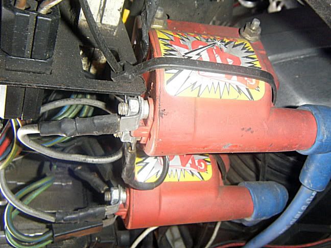

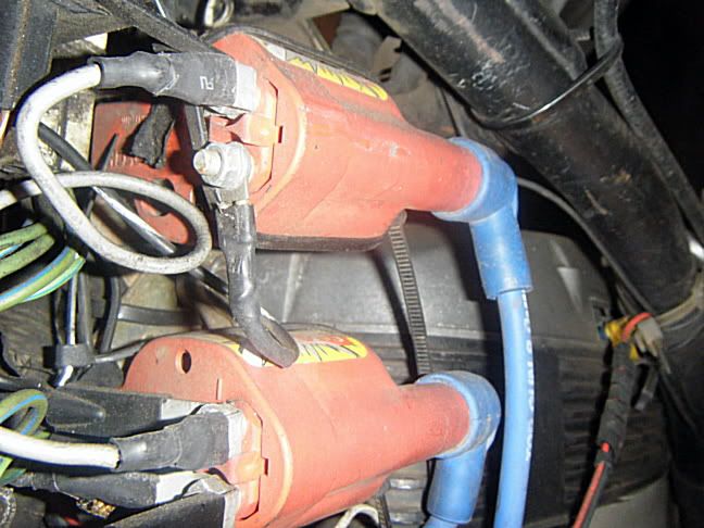

« Reply #39 on: January 03, 2012, 11:06:18 PM »
Hi guys, I had the same thing with my stock coil (83 LS) out of sheer desperation I riged up two GT-40 coils that are ment for cars, so now my cylinders have a coil each and the beast thing is if I have one fail I can just take it out of the circuit and run only one to get me home!, yes that involves splicing the spark plug leads together I know but hey if it works it's all good  ;). if you guys want I can post photos of my set up?.
benlawlor85
Re: wont accelerate, coughs and stops...?
« Reply #40 on: January 05, 2012, 05:19:21 AM »
would be interesting to see the setup joe!
Sergeant_Joe
« Reply #41 on: January 07, 2012, 12:59:27 AM »
Twin Coils on my R65 LS.
This is much cheaper and puts out a really good spark.  I have never had starting problems since I put these in.  They have been in for about three years now.

Thanks for the pics looks interesting.
