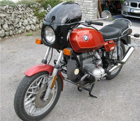

I don't see any reason the RT bars would not work, I don't think the dash panel will cause you any problems.
I could not picture that fairing in my mind, so I went to Google Images and found this:
Is that your bike Boycie?  The website where I found the image is quite interesting - lots of beemers!
No, its not my bike, but it is almost identical. mine doesn't have those cases, and my fairing is plain white, other than that, the same bike. Although mine is, of course, much, much cleaner ;D
