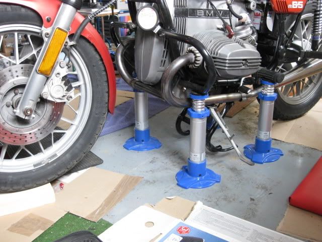

It was a rainy afternoon here so I decided to get at it and remove the stand, even though the new one has not yet arrived, I didn't use the sump as a lifting point in the end, instead used some car support stands under the pegs and crash bars:
I have now removed the stand, but about those "sheet metal shackles" as Monte called them, that the springs were attached to, is there some knack to removing them?, I could not see how to remove them
