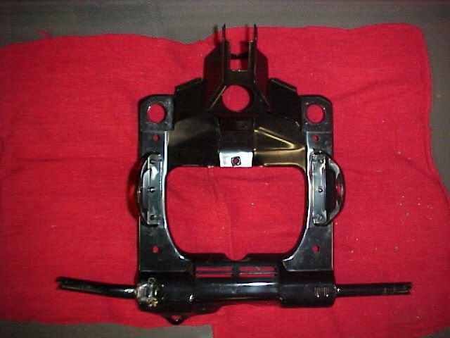

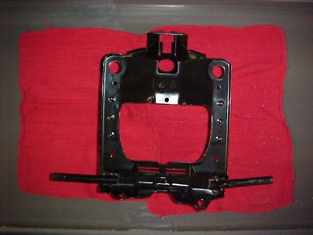

« Reply #14 on: January 29, 2011, 09:15:12 PM »
I have a slightly damaged standard R65 bracket that I could let go of.  I think I have pictures on this sight somewhere...let me see what I can find.
---found a picture or two---
Pretty good shape, just a damaged turn signal stalk.
PM me if you're interested.
