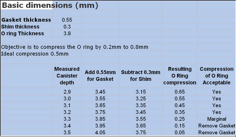

You have everything that you need but have you read up on the $3000  O ring and how to determine correct O ring compression ?  I take it from the Exclamation mark in the title that you probably have.
You need to measure the canister depth then calculate the resulting compression of the O ring.  The state of the O ring you take out will be a good indication of whether it was under the correct compression. It should be squashed somewhat square but not extruded at the edges (that would indicate too much compression).

« Reply #2 on: January 03, 2011, 05:23:36 AM »
From what I have read, If i'm using the paper gasket, I need to have one or two shims before the white o-ring depending on the canister depth to achieve a desirable o-ring compression.
Ok, I'll just follow the table you provided.

Julio, Because the canister depth can vary from one bike to another there is no set number of shims and gaskets to use. That's why ideally you should measure your canister depth and then decide if the paper gasket is needed.
The shim is always needed (except on some later bikes that have a rolled canister edge) to protect the O ring from the sharp edge of the canister.
The gasket is need or not depending on canister depth.
The filter will have come with square ring seals bonded to both ends so you don't need to worry about them except to be sure an extra one is not left inside the engine.

After doing this procedure I found that I needed 2 shims and no paper gasket.  And I only have to snug those three bolts down.  I was tightening them a lot before.  I'd hate to have to put a helicoil in the dang things -- they're so small.  It was simple and it's nice to know where my machine's canister was set.
Knowledge is good right?

Unless you know (for sure) that the PO measured everything, you should check it.
